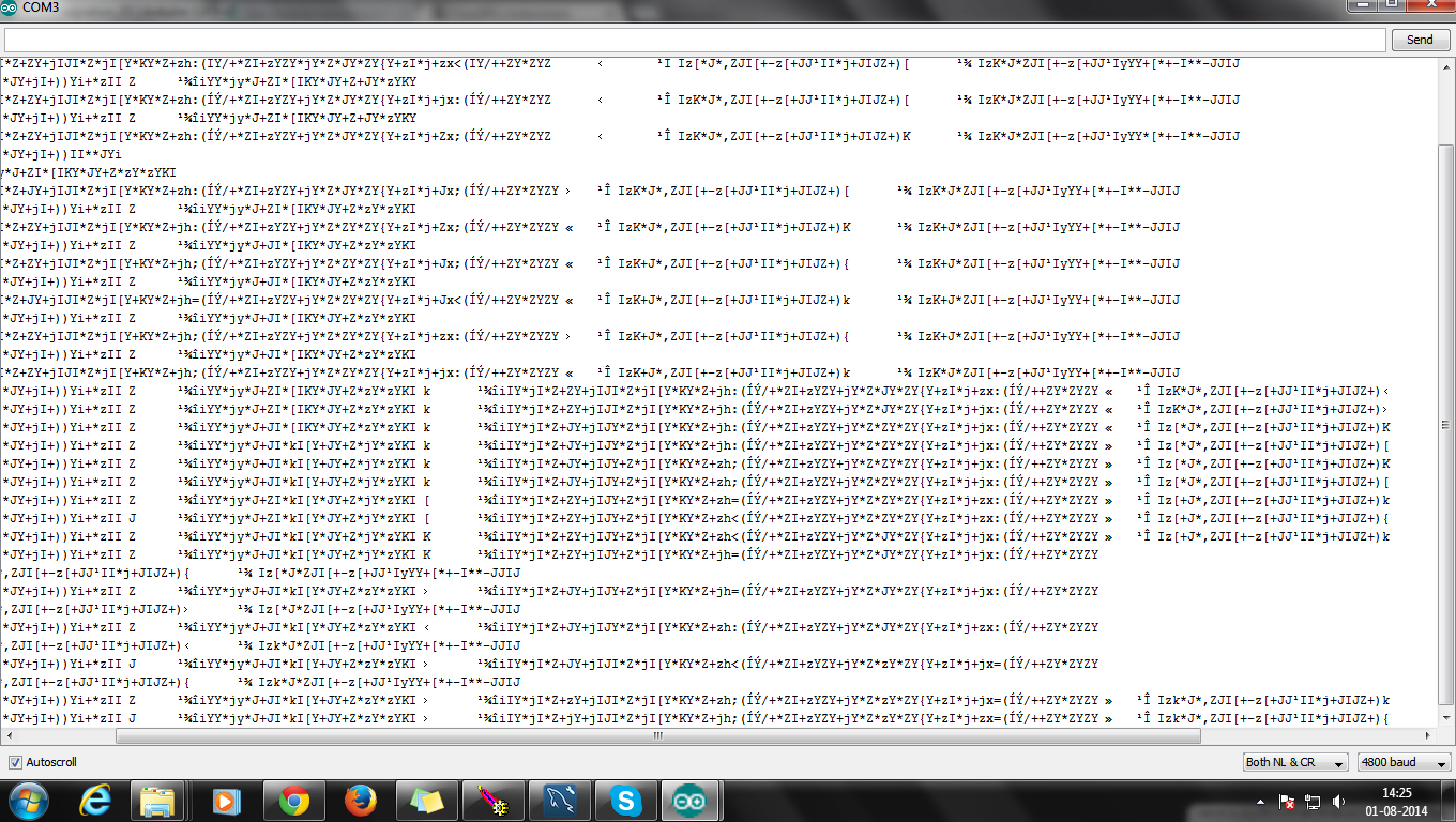

Below is the output's screenshot (as Attachment) that I get:

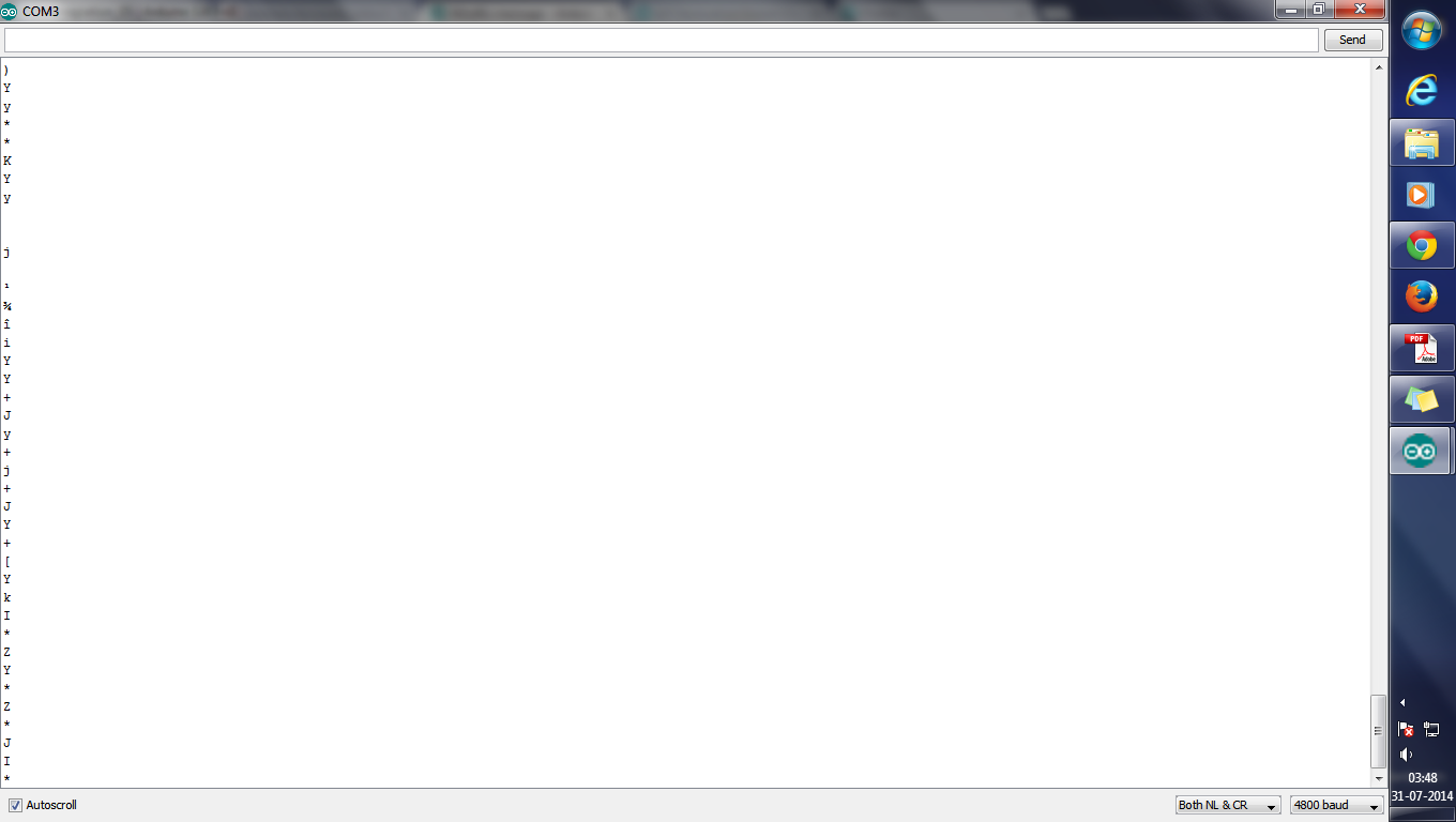

This is the simplest code that I have tried So far... returns similar output (Output's Screenshot is attached)

That looks like you have the wrong baud rate. I suggest that you put together a small program that just reads from the GPS pin and prints what it gets. The sentences should make sense, and yours don't.
Just cut the code down to do a read a character from the GPS and then print it. You should see the sentences come out with the data in it. When you do this, attach the GPS to the sofware serial port, and use the regular serial port with the arduino IDE, don't try to use the serial port in a split mode where you have one pin hooked to the gps and expect the other one to talk to the IDE.
So, move the GPS tx pin to the software serial input pin, and try to just read from the GPS and output it through the regular serial port. Remember to set the baud rate of the software serial port. You don't have that in the first code you posted, but do in the second. Something like this:

I have tried what you said... using your code...
#include<TinyGPS.h>
#include<SoftwareSerial.h>
TinyGPS gps;
SoftwareSerial ss(10,11);
  ss.begin(4800);
  Serial.begin(4800);
  while(ss.available())
    int c = ss.read();
    Serial.print((char)c);
    if(gps.encode(c))
      Serial.println("Got Fix!!");
The output I got is Attaached Below, but makes no sense (!?)
GPS sentences start with a $ and end with a carriage return, what you're getting looks like one of the baud rates is wrong. Looking at the datasheets vs code examples for this chip I see both 4800 and 9600 being used as the rx baudrate. So, just to set that possibility aside, put a Serial.println("Hello World"); right after the Serial.begins to be sure the IDE terminal is right, then try different baud rates for the ss.begin()
I've seen different baud rates for different chips, your problem could be something like that.
