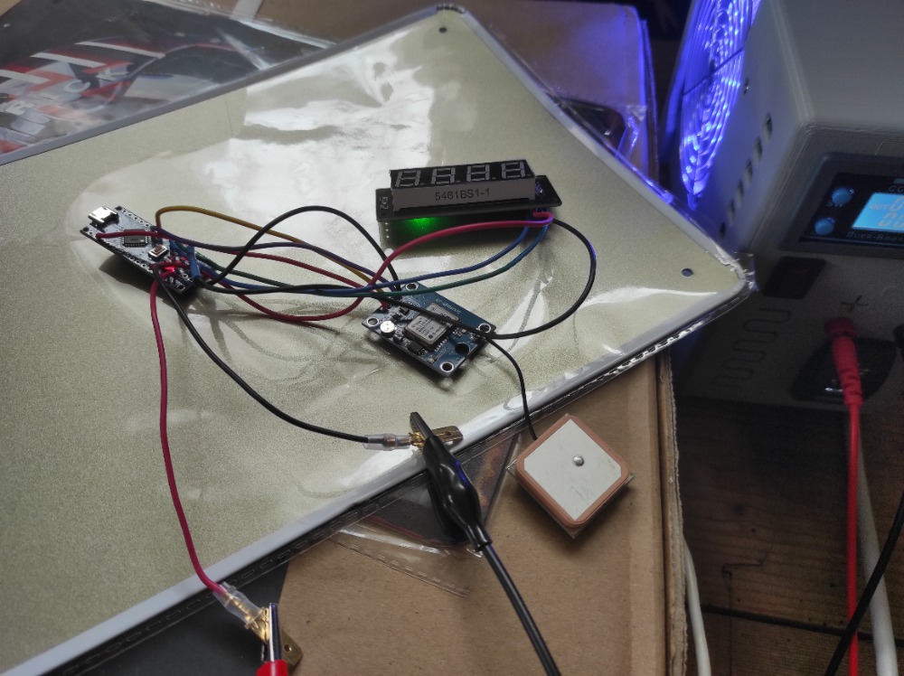

Maybe I found the cause of the problem. I put the boards under a large magnifying glass and found one chip on the GPS board. I do not have a hot air soldaker for repair, so I have ordered a new module so far.
So, what is wrong with the chip?
It is soldered crookedly on the board and one leg was in the air.
Photo of the assembly
Excellent photos. Tells us so much. Thank you.
I'm currently using the same GPS module. Yours does look a bit skewed. It is surprising that one leg is not soldered down. But you say that the LED is blinking -- that's a good sign. You need to look at the raw GPS output to see if it is working. Too early to worry about getting the speed.
Looks like you do 3D printing. That's a serious looking power supply. Sooner or later the antenna's tiny cable will break if you leave it loose like that. Never connect or disconnect the antenna cable with power on. Never.

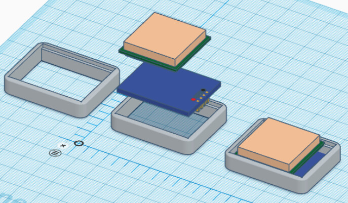

I have broken several antenna cables. The connections are weak. I made a frame to hold the antenna to the GPS board and protect the cable:
The Tinkercad file is in this discussion:
