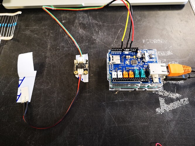

I bought a couple of these:
Gravity sensors
From that link, connecting the sensor and running the sample code as described, the output reads either 1023 or 16/17 and touching the Piezoelectric film has no effect. In fact, unpluging the film entirely makes no difference to the output.
Am I missing something obvious with this?
#define sensorPin A1
  int x = analogRead(sensorPin);
  Serial.println(x);
  delay(50);

Do you use the analog output of the module ? The switch should be to "A".
Can you show a photo with the wiring ?
If you have a multimeter, then you can measure the voltage over the piezo element.

I suspect 5v is on the signal wire (wires crossed?).

Wires are colour coded and 5v and GND are red and black so wired correctly, green wire goes to the analouge input although it is blue in the wiki. Can try and transpose them to see if it makes a diference.
As per the instructions on the wiki, the switch was set to 'D' although connected to the analog inputs. Setting it to 'A' is just a stream of values between 300 and 800 and again, touching the piezo film or even removing it made no difference to the output. I sholud note that I bought 3 of these and all react the same. Also have 2 Arduinos and tried with both.
The project is at where I work so will add the output tomorrow whan I am back but with the sensitivity pot all the way up it is just a stream of 1023 and all the way down it is fluctuating between 16 and 17. inbetween it randomly shows either. touching or removing the piezo film makes no difference.

I have updated the post with a picture of the setup and screenshot of output. The output is unchanged when flexing / touching the film or even with it unconnected.
The 1023 is as HIGH/1/5v when you use D(igital output) with "17/18" as LOW/0/0v. The 17/18 should be zero, so you have a grounding problem or your sensor has an internal ground problem.

The Wiki page for this that is linked in the post has 1023 an 11 as the values from the digital output.

The white plastic knob to the <- left of the three-pin connector might be a trimming potentiometer that possibly could get "11" down to "0" - check your sensor documentation.

The knob is a trim pot and adjusts sensitivity, all the way up the output is a constant 1023 and all the way down is a constant 16 but again, does this without the film connected.
I Will check for earth problems but I doubt that is the issue.
