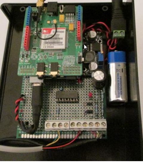

You cannot use a 9v battery as the board specifies 5v input only, so you need to use a regulator of some type.
Have a look around, most folk have a pile of old chargers around, you just need one thats 5v and at least 1A.
Like that picture I posted of mine, using a 9v battery for backup, BUT the battery runs though that little Step down converter , set to produce 5V even when the battery is below 5v.
If you only have 9v or 12v supplies then you need one of those little step down coverters or a simple 7805 regulator.

You might find some helpful info in my sms project here -
https://dl.dropboxusercontent.com/u/5285770/ARDUINO%20%20SMS%20%20CONTROLLER.zip
It uses both a 12v power pack and 9v battery via a converter board, but you could just use a simple 7805 regulator instead powered from a 9v or 12v source

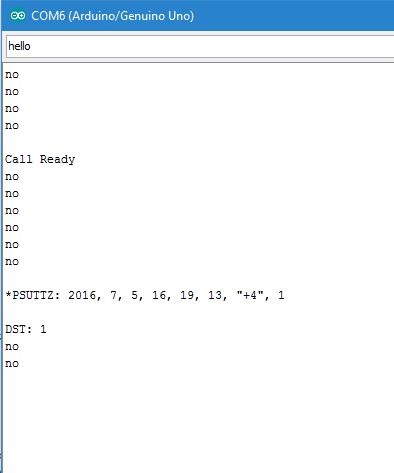

Have you soldered JP, the code uses software power control, so if you have not soldered JP and first press the powerbutton, when the code runs, it then turns the sim board off; if it does, press the PowerKey again and it should start transmitting.
Watch the RED led, it should remian ON while you do the testing.

So let me get this straight... what I should do is THIS:
  1. Upload this new code to the Arduino
  2. Solder JP
  3. Plug in the shield
  4. Power on Arduino
    5.Power on shield by pressing button
    And then from there it should work? That is all I need to do to make it work?
Yes, thats how I have mine working now to produce that screenshot.
My board is also the geeetech one.
Edit, no need to press the Power button if JP is soldered
