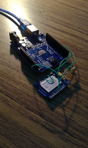

I'm Sven and I have a Arduino uno connected to a A6 GSM module with the following connections:
Arduino ---- A6 module
D2 UTX
D3 URX
GND G
5V VCC
5v PWR
In the GSM module I inserted a simcard from which I removed the PINlock and the simcard is able to call someone (I have put the simcard in a cellphone and tried to call myself and I received the call)

This code makes (read "should") the arduino uno communicate with the GSM module using a softwareserial connection and should initiate 2 phonecalls to the chosen phonenumber and after this it should call every ten minutes. Instead I don't get any phonecall at all.
Plugging the arduino in a wall adapter (which can deliver more power) doesn't effect my results.

With this code I can write commands in the monitor and view the response of the module.
It responds 'ok' if I send AT so I guess it's not a communication problem.
When I manually send ATD+phonenumber I get semi-gibberisch (see picture attached) which seems like 'cme error 500'. What I did found about this error is that I might need a country code in my phonenumber so +324.. instead of 04... But changing this didn't affect my results. Other causes of the error that I find on the internet are no connection but I tried in open air and still same results.
Another thing: I have a similar setup that I made in the past with the only differance that I used this module:
https://nl.aliexpress.com/item/A6-GPRS-Pro-Serial-GPRS-GSM-Module-Core-DIY-Developemnt-Board-TTL-RS232-With-Antenna-GPRS/32837194502.html?spm=a2g0s.9042311.0.0.27424c4dUDCk2s
instead of the one from the picture attacted.
So I wonder if anyone can help me to figure out why the module won't make the call!
Thanks Sven!
[solved]
