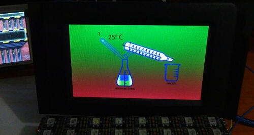

Hi all,
I have a project idea and i want to know if i can acheive it using arduino and one of the graphical LCDs, i need the LCD to monitor a drawing like the one attached.
please advise about the best LCD that i can use.
thanks
m_swalha:
Hi all,
thanks
Maybe with a gameduino 2
Yes, you can do this with a black& white LCD. Or a backlit LCD. Or an OLED. Or with a full colour TFT LCD.
You have a custom LCD with custom icons and shaped segments. It will use miniscule power.
The alternatives will be "universal" Graphics displays. e.g. 128x64 square pixels or higher resolution.
They will use more power and might look a little blocky.
If you have USB or mains power, it really does not matter how much current a replacement display uses.
David.
