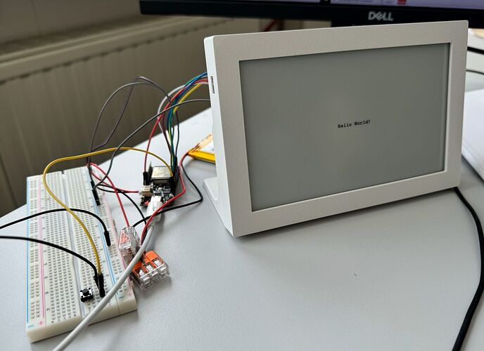

Hello again. Unfortunately it does not seem to work. :frowning:
Hardware:
  • FireBeetle 2 ESP32-E
  • DESPI-C02
  • Good Display GDEY075T7
GxEPD2_4G does not seem to work with the new 800x480 model GDEY075T7 (4 grayscales) from Good Display.
GxEPD2 works without problems, GxEPD2_4G does not - of course no PINs changed.

I have solved the problem.
The problem was that the "GxEPD2" library was still in the "platformio\.pio\libdeps\dfrobot_firebeetle2_esp32e" folder.
Folder GxEPD2 deleted, "platformio.ini" edited (lib_deps), rebuilt, uploaded, running!
I don't understand why this was used, although there is no "include" in my code, probably a normal behavior of PIO. Probably some functions in GxEPD2 are duplicated with those in GxEPD2_4G and thus caused my problem.

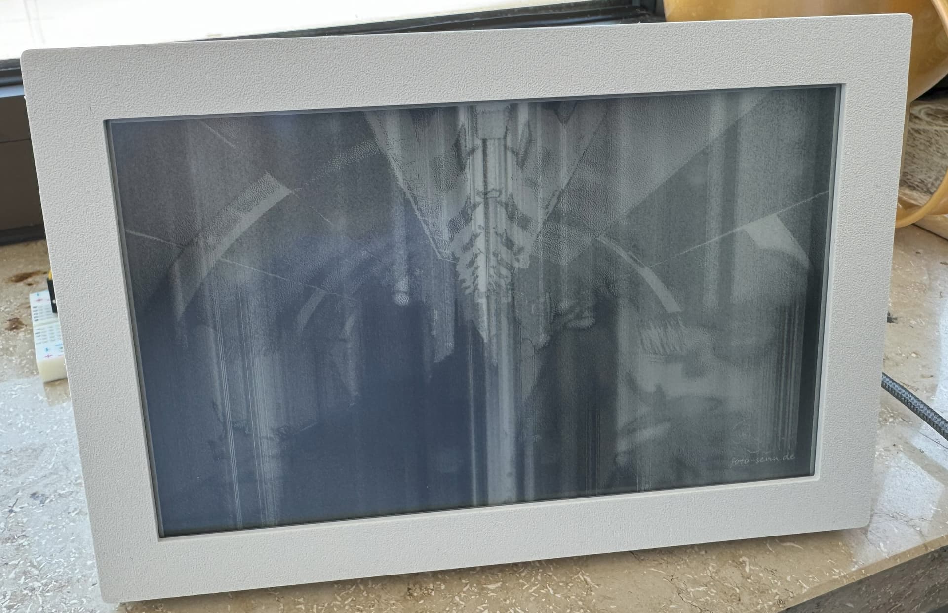

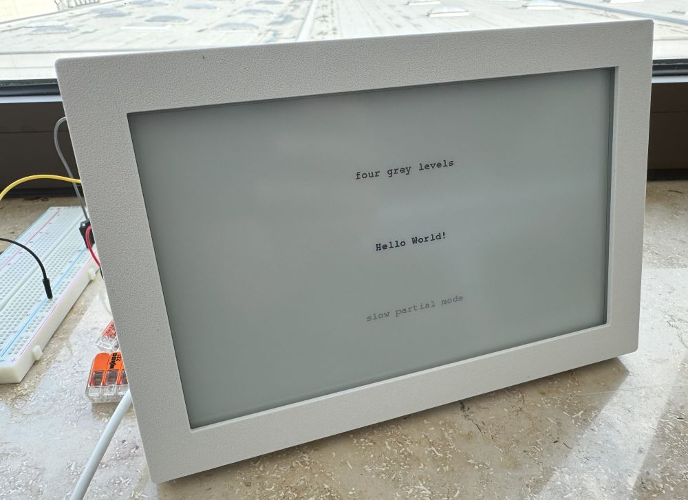

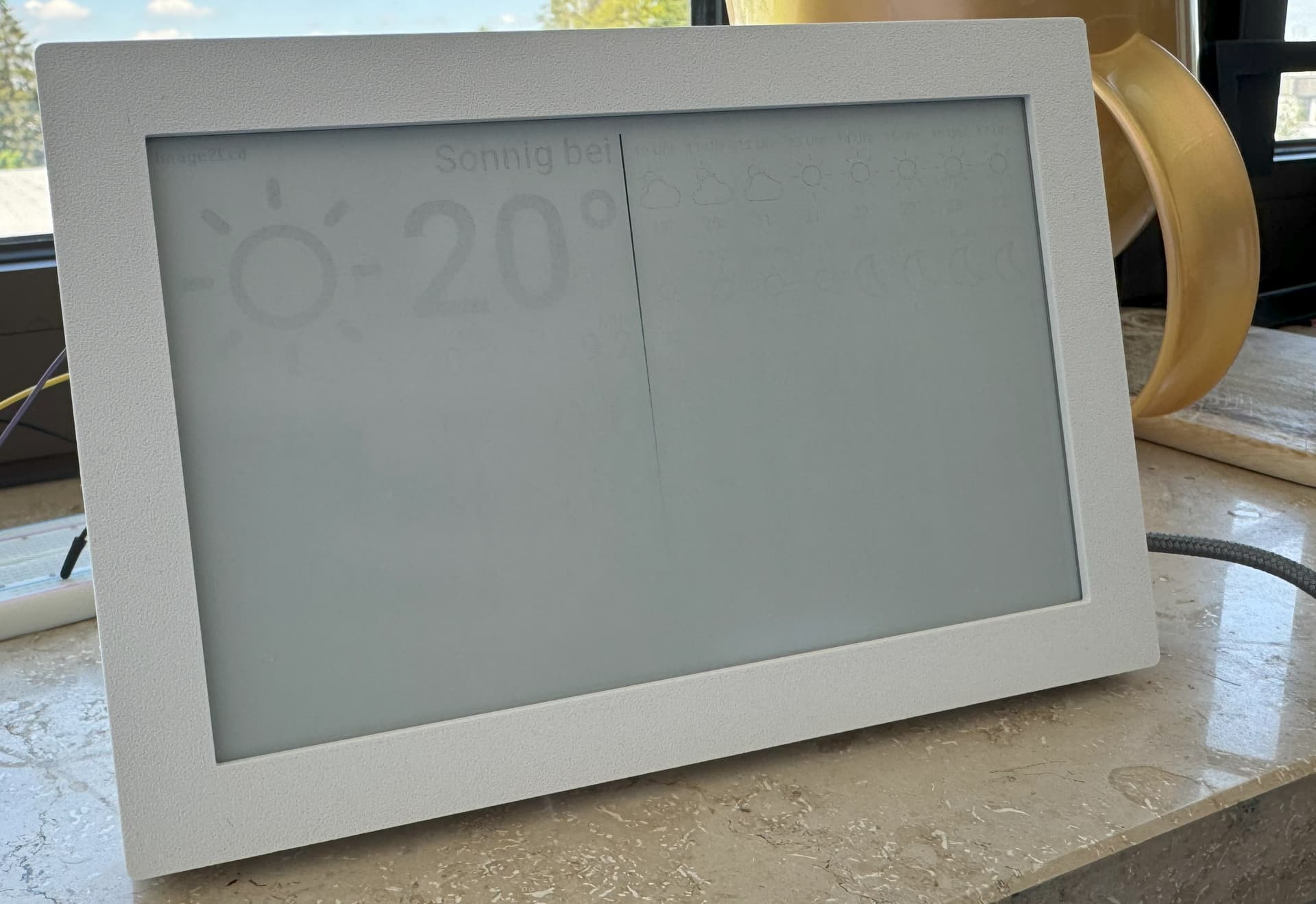

Hello again, a few hours have passed and my wife and children are really annoyed with me.
Hour after hour, I've got a little further and further, and in the end I just couldn't explain some of the problems any more. That's why I have dismantled everything and started in a very rudimentary way. I noticed that I have problems when displaying "more complex" bitmaps. I have stripes from top to bottom on the display when an image is inverted or when it is not inverted, the upper area is very slightly visible and then simply runs out.
I have to say that during the display refresh, the image is sometimes displayed correctly for half a second before it ends up looking like my pictures.
However, I can display the example bitmap "Bitmaps4g800x480.h" with display.epd2.drawImage_4G without any problems.
Here are a few pictures:
My own example 1-bit bitmap, works, but without greyscale (display.drawImage)
Example 2-bit bitmap with graysacle looks good (display.epd2.drawImage_4G)
My own example 2-bit bitmap, the upper area is very slightly visible and then simply runs out (display.epd2.drawImage_4G); when inverted, stripes from top to bottom
Example 2-bit bitmap from florian-senn @ github (display.epd2.drawImage_4G)
I have uploaded the example code and the bitmaps used here, should anyone want to recreate it or help me.
I can rule out a bug in GxEPD2_4G, I have also tried older versions.
  • Perhaps there is still more to adapt for the GDEY075T7? @ZinggJM
  • Could it be a hardware problem or a bad solder joint?
I would appreciate any help.
Best regards

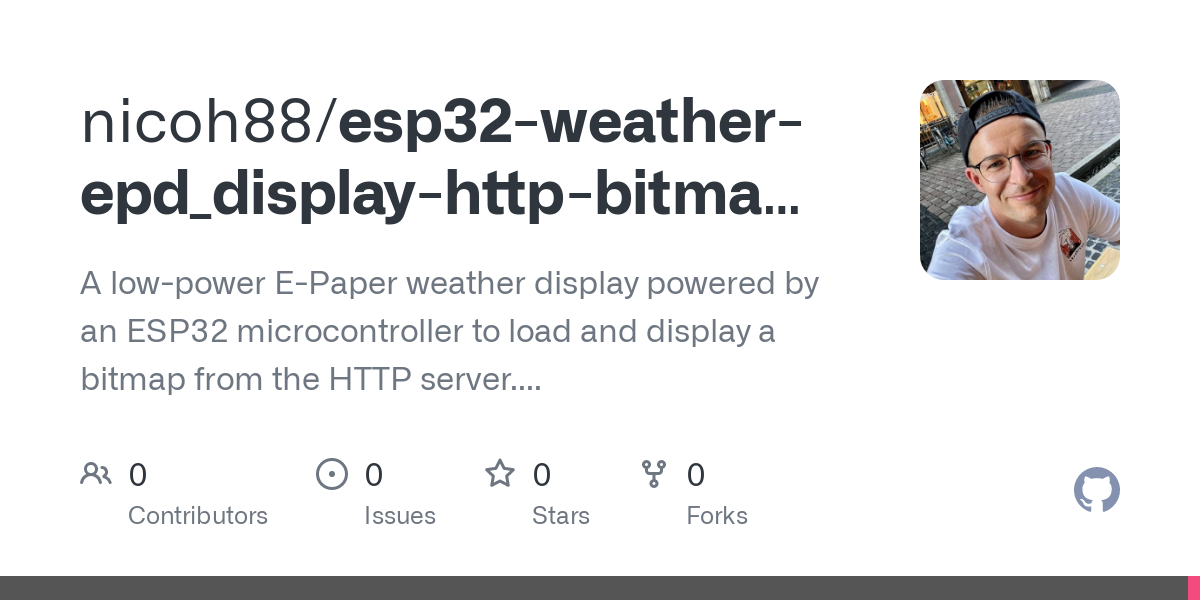

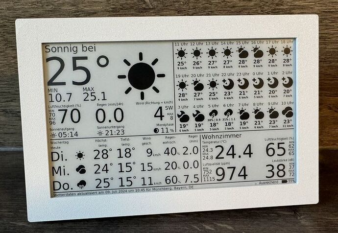

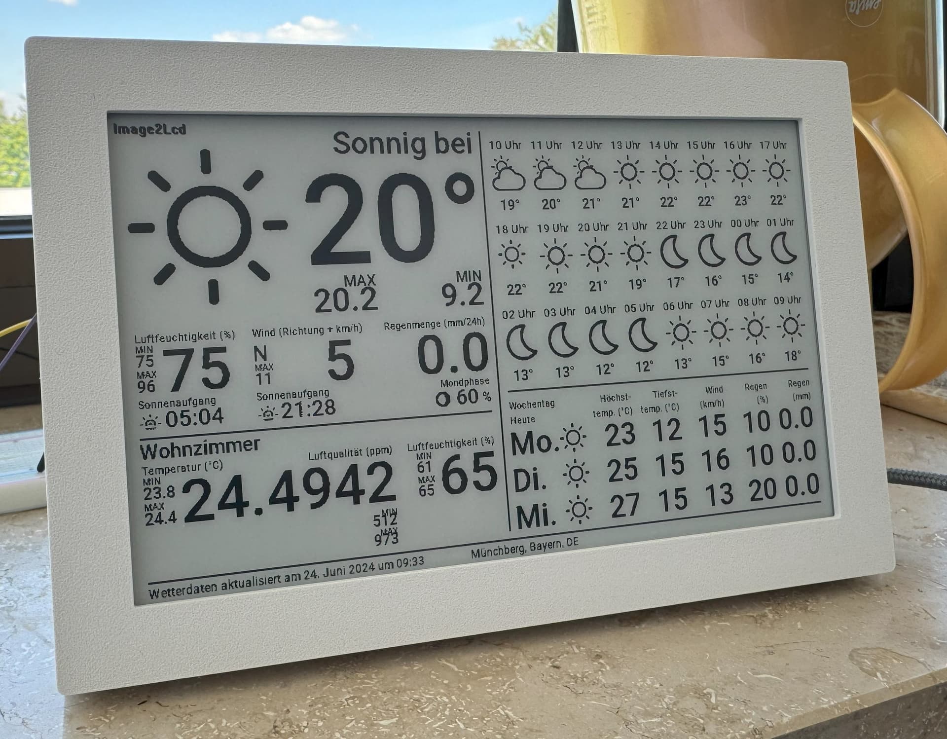

I would just like to briefly inform you that I was able to solve the problem a few days ago. It was due to additional parameters for the initialization of the GDEY075T7 display.
Here is my fork of the GxEDP2_4G: GitHub - nicoh88/GxEPD2_4G
Here is my whole project which I finished a few minutes ago:
