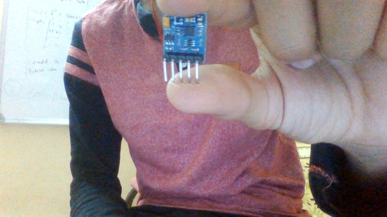

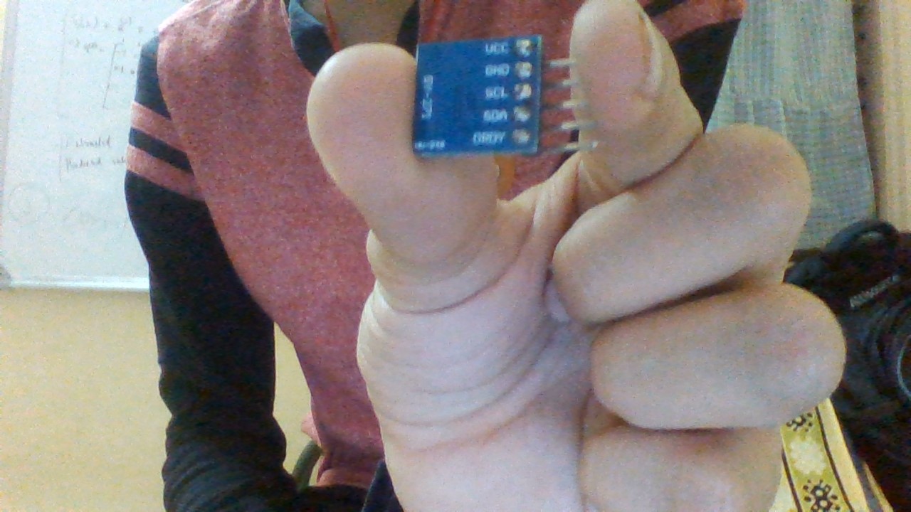

Hey. Thank you so much for replying!
So here are the details :
1 - I am using a basic Arduino UNO board
2 - Here are the connections (VCC -(3.3/5 V), GND-GND,SCL-A5,SDA-A4)
3- the Arduino Uno board was available at my office(not sure from where it was purchased)
4- The sensor was purchased offline ( from an electrical shop)
5- I am using I2Cdev library developed by Jeff rowberg
I have added few images to attachments! Sorry for the bad quality of images!
p.s - I am someone from software background and very much new to this hardware world
Looks similar to the Adafruit one, try their tutorial I pointed above
