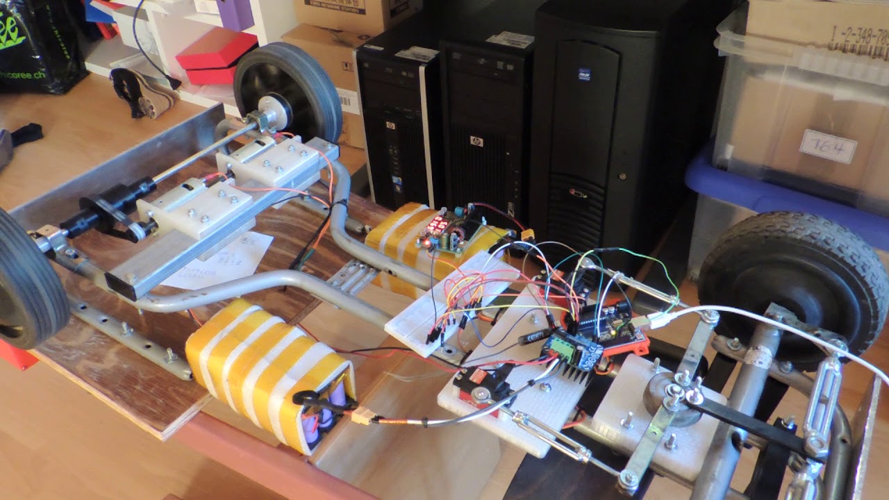

I'm wondering if this can be used as an H-bridge to control 2 DC brushed motors,
i.e. 1 motor for forward/reverse, 1 motor for left/right on a lets say hobby level car.
or other applications where high current or voltage loads may be necessary.
i.e. like this EV car below.

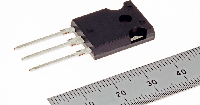

At 100A you'll need multiple paralleled MOSFETs, or extremely bulky stud-terminal devices
like this: https://uk.rs-online.com/web/p/mosfets/1684576/

All electric cars seem to use IGBTs, not MOSFETs. Its the natural choice for high voltage. With
low voltage they are too inefficient to be useful (less than 200V for instance) - low voltage high
power is for MOSFETs.
But at high voltage IGBTs are more robust than MOSFETs, as the gate is better protected from the
drain/collector and they naturally scale to high voltage. Its incredibly easy to blow MOSFETs at
100's of volts that no-one really wants to risk designing with them when IGBTs are available
(the 'standard' IGBT breakdown voltages are 600V and 1.2kV)
Newer devices are coming along based on wide bandgap semiconductors, so this will all change soon
with GaN and SiC devices coming to the fore, some of these are HEMT style MOSFETs which are
different yet again. There's a small chance too that diamond-based semiconductors will become
practical too, perhaps the ultimate wide-bandgap semiconductor, being a way better thermal conductor
than any other material at room temperature.
But you always need good protection circuitry for high power, or you have something that works one
day and vaporizes the next...

Interesting. I wonder where the 200V number comes from?
IGBT typically has 1.8V forward voltage, so at 10A dissipates 18W.
200V MOSFET typically has 100 milliohms on-resistance or so, so dissipates 10W at 10A,
so this is the kind of voltage where conduction losses are roughly comparable.
At higher voltage MOSFET losses increase as the on-resistance increases with voltage rating,
at lower voltages IGBT losses increase (as a fraction of total switched power, since the forward
voltage is fixed).
As voltages increase the fast switching of a MOSFET has to be deliberately slowed down to
limit the dV/dt value, since if that's too high the device can destroy itself though internal
capacitive coupling between drain and gate - IGBTs are less sensitive to this and switch
slower in the first place - hence the robustness. Basically IGBT has one more layer of doped
semiconductor between the output terminal and gate, which helps protect the gate.
