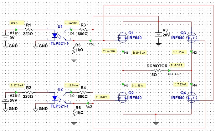

Hello everyone, as my circuit describes itself, nothing is so complicated. A simple H-bridge circuit which controlled by arduino nano, two digital pins and two pwm pins.
My problem is, when I powered the circuit, I got a short between 12V and GND... by troubleshooting I found that Q2 is shorted, so I threw the whole board and soldered a new one, but, I got the same thing again!
Can someone tell me where's my wrong?
P.S. Q1 and Q2 are IRF4905
Q3 and Q4 are IRLZ44
T1 and T2 are BC548
T3 and T4 are 2N3906
EDITED.

Circuit is wrong. Q2 is wired to 12V, so it will pull the Arduino pin up to 11.3V or so, not good news, though R4 probably saved the Arduino from instant failure.
Where did you find this circuit?
I just made it myself based on many circuits which found in datasheet. But I didn't understand where's the wrong in connecting Q2 to 12V. Arduino pin isn't connected to Q2, but to T2.
Q2 Vgs is -11.981v according to simulator which I tested the circuit with before building.
Whoops, I meant T3, the PNP device which is shorting the Arduino pin to 12V via 150 ohms.

Do you understand about Vbe voltage drop being about 0.7V?
Anyway the circuits just wrong. Typically the lower n-channel MOSFET would be logic-level and driven
direct.
Yes, that's a short to 12V.
A BJT transistor looks a bit like two diodes in opposite direction. So the EB junction of T3 (and T4) is like a diode pointing towards the Arduino. The second diode would be the CB junction. An NPN is likewise but in the opposite direction.
Drop T3 and T4, connect the gate of Q3 and Q4 to the Arduino pin directly. The IRLZ44N will be fully on at 5V on the gate.
Note that Q1 and Q2 are slow to turn off, as the gate is discharged through R5. It will turn on fast, as it's charged through T1 with no current limiting resistance.
Q3 and Q4 will switch faster as the gate is charged and discharged though just a 150R resistor, after correcting the circuit.

Is it correct now?
New schematic below
No, even more disasterous error, you've shorted the gates to ground! And you've used an emitter follower which is not needed at all, nor is it a switching circuit.

Thank you for your reply. I thought of doing this but as datasheet paragraph says, at 5V on Vgs, the mosfet can't drive 12V load with full amperage. the current will be limited.
One more thing, in my plan Im not going to use IRLZ44N, not IRL4905 neither! they suck! But as they are DIP components so I can use them as far as I'm testing circuits home.
Can you please chech the 2nd schematic and tell me what do you think?

So just controlling the two n mosfet gates direct like this?
H-bridge.pdf (10.7 KB)
Yes, but do bring back the pull-down resistors on the gate. Don't ever leave a gate floating (and they will be when the Arduino is powered down or just starting up).

The gate of Q1 is pulled down strongly with the force of a hard driven transistor,
but pulled up weakly with a 4k7 resistor.
Would be better to even that out somewhat.
Change R5 to 470 ohm (or 1k), and R1 to 4k7 (or 10k).
Same for the other side.

Silly question but why is there no motor shown in the schematic ?
