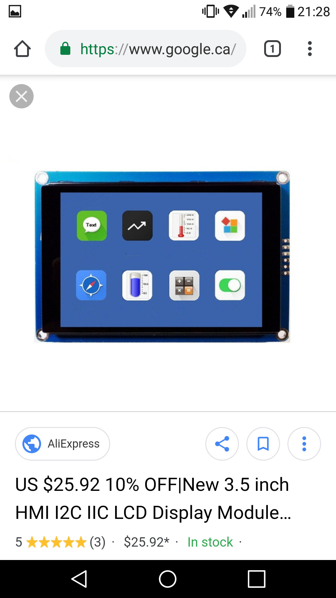

Hello. Bought this touch screen for Arduino. ( attachments pictures) I cant find ANY test sketches or any info at all how to make it work. Best I get is a light blue screen :frowning: Anybody tried this ? Pretty new at Arduino ( I'm not bad but no big expert)
Can you share a link to where you bought it from please?
