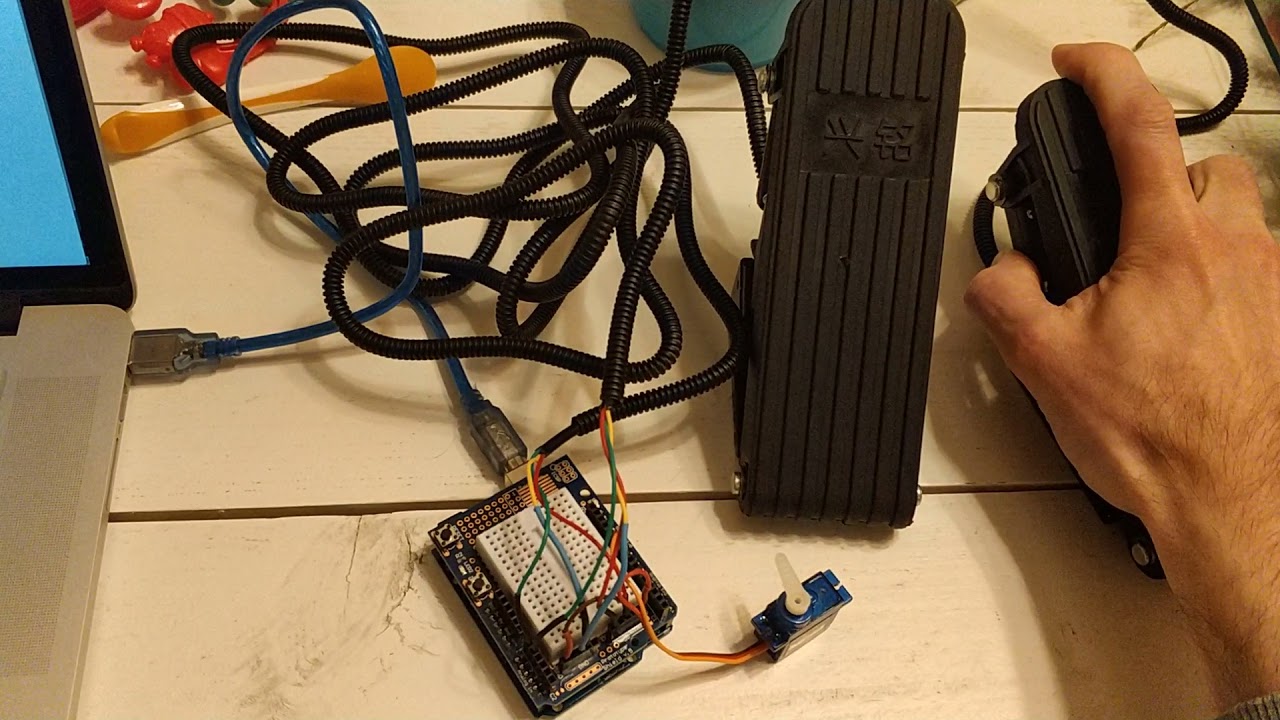

I hope somebody can help me. I am trying to write a sketch for controlling an RC car with separate throttle and brake pedals via one PWM signal. My skills regarding feeding an all-in-one Arduino PPM stream into the trainer port of my radio is way beyond my knowledge. So for starters I'm going to feed the PWM signal into a PWM-to-PPM converter of which I have positive experiences with. (I hooked up a servo tester this way and BAM, I added an extra control knob to my radio)
I am using affordable $10-$15 Hall sensor pedals from Aliexpress. So far I received one, the rest is in de mail on a slow boat.
The problem: The servo goes in one direction for a bit, then sweeps all the other way when the Hall sensor is connected to A0. The same behavior applies for connecting the hall sensor to A1.
Is this because the Uno expects signals on both A0 and A1? As I have only one pedal atm, I switch between A0 and A1, hoping for correct behavior of the servo.

@TomGeorge Thank you! As I was pondering my post of earlier today, the mailman stopped by and dropped an extra foot pedal. Approx. 7 days from china to Europe. No idea how. The code however behaves the same. Railroader and you both suggest that the solution is somewhere in my mapping. I'll try to find a different approach how to use it, and report back.
I've also added a circuit diagram.

There's isn't really a lot to show here I'm afraid. The hall sensors are directly connected to A0 and A1 of the Uno, the PWM signal/servo has D9 as output.
My code works perfectly fine, precise even when using code for one Hall sensor pedal. It either goes the whole range (180 degrees) or 90 degrees in one direction, depending on the mapping numbers.
But having one pedal to control the servo angle 90 to 0 degrees and the other pedal 90 to180 degrees is something not as easy as I thought it would be.

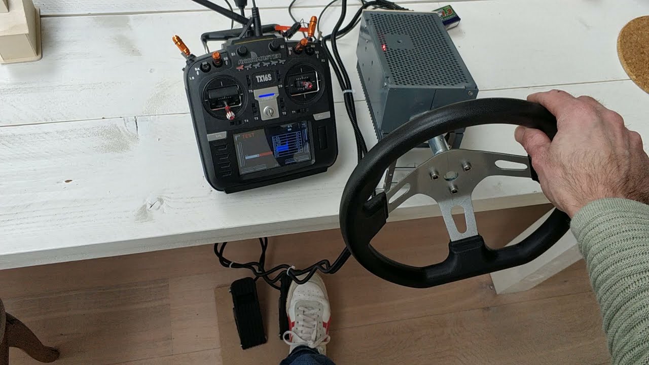

Next step is adding a potentiometer input for steering. But that's easy as it's just a servo tester.
Good. Keep up the wind in the sails.
Hi Hans, any update on getting it connected to the trainer port yet? Im attempting to do something similar with a Futaba transmitter and some arduino libraries for sbus.
This code is tested for Throttle+brake and steering as input. I haven't tested the headtracking input yet (pan/tilt).
Be aware you still need a PWM-to-PPM converter to get a PPM trainer input signal. I got too busy with life lately and I hope to find time to eliminate the converter and do it all with one Arduino.

  Val1 = analogRead(Hall_SensorT); // read the analog Throttle input
  Val2 = analogRead(Hall_SensorB); // read the analog Brake input
  Val3 = analogRead(SteerW); // read the analog Steering potentiometer
  Steering = map(Val3, 0, 940, 0, 180); // mapping the potentiometer value to a 0-180 range 1023
  //Val1 Tested with code for single Hall sensor 180, 850, 90, 10 from Neutral to Max Throttle
  //Val2 Tested with code for single Hall sensor 180, 850, 90, 170 from Neutral to Max Brake
  if  (((Val1 >= 180) && (Val1 <= 850) && (Val2 >= 150) && (Val2 <= 179)))
    angle = map(Val1, 180, 850, 92, 180); // from Neutral to Max Brake
  else if (((Val2 >= 180) && (Val2 <= 850) && (Val1 >= 150) && (Val1 <= 179)))
    angle = map(Val2, 180, 850, 92, 0); // from Neutral to Max Throttle
  myservo1.write(angle); // Arduino Throttle/Brake pin 9 to PWM-to-PPM converter
  myservo2.write(Steering); // Arduino Steering pin 10 to PWM-to-PPM converter
  myservo3.write(anglePAN); // Arduino Pin 8
  myservo4.write(angleTILT); // Arduino Pin 7
