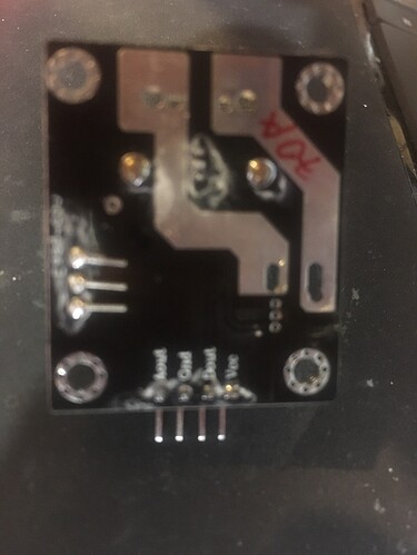

Hi. I have this hall sensor module . How to connect with arduino and which code should I use!
Vcc - to 5volts
Dout- ?
Gnd- to Gnd
Aout- ?
I Want for DC.I will put it on the positive cable? thank you.
You must provide a schematic of your module, there is at least a chip on the module which probably is some ADC but we must know which one it is and how it's wired to the sensor and the outgoing interface pins.
Where will I find them? Are shown in the photos?
They should be supplied by the shop where you bought the part. Never buy parts if you don't get the schematics or you pay much more (in time) for it because you have to reverse engineer the needed schematics yourself.
No, at least not in these photos (much to blurry). Don't expect us to do your job. If you don't get the schematics from the supplier of the device, follow each trace on the board, identify all the chips and other components and draw the schematics yourself. And yes, this is time-consuming, that's why cheap boards are often more expensive in the end than the counterparts from the quality sites as Sparkfun, Adafruit and the like.

LM393 is not an op amp but a comparator. I guess that one together with the potentiometer (blue) produces the Dout signal as soon as the measured current is above the adjusted limit.
This means you might get the output of the WCS1700 directly to the Aout pin. Using the standard analog input you get a resolution of about 0.2A and an accuracy of about 1A. Using the internal ref voltage you can push the resolution below 0.1A and the accuracy to about 0.2A.
As the description already says you can use it for an overcurrent detection but don't expect to measure current exactly. What do you want to use it for?

Hi. I want to stop the motor jet drive If the pump sticks to algae, bags, net, etc.The motor consumes continuously 1300W 24v 55A , if take over 60A to stop the motor.

The wiring is already done. The output of the analog input gives you the current with the following formula: I = (readA0 - 508) * 78 / 512. The 508 is empirically identified (see above), the 78 are simply 2.5V / 32mV and the 512 are the steps the Arduino returns for 2.5V on the analog input.
