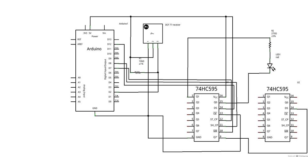

I've build a schematic with fritzing.
As fritzing doesn't have LED matrices in the size I'm using I've left 'em out. The matrix pins are connected with the shift register outputs in now specified order. I've connected them in a way to keep the wires as short as possible and least confusing.
The latch pin (arduino pin 7) is connected with all ST_CP pins on the 595ers. The clock pin (arduino pin 8) is connected to all SH_CP pins on the 595ers and the data pin (arduino pin 12) is connected to the DS pin of the first 595er and the Q7' pin of the first 595er is connected to the DS pin of the second 595er and so on. OE is connected to ground on all 595ers and MR to high (+5V) on all 595ers. I've left those ports out on the schematics.

Okay, sorry :wink: I've created a schematics with fritzing now and attached it as PDF and JPEG.
It shows the wiring of the DCF77 receiver (which is working fine) and two shift registers. I've wired the first one completely except for the matrix (as there is no matrix part in fritzing) and connected the Q7' pin to the DS pin of the second. This repeats for all 5 SRs, so i left out the rest. The single LED I've added is just a "placeholder" for the missing matrix. Each matrix has 14 pins of which 12 are connected to the SRs in no special order.

Hi Hawkes,
In your schematic, Q1 sources the current to drive the LEDs and Q0 "sinks" it. This will work AS DRAWN, but in your OP you state that the problem is when more LEDs are on. The problem is that the 74HC595 can only "source" 35mA (try to find this fact in the spec as practice for future projects; hint its under table 4. Limiting values). So as soon as you are driving a few LEDs you are exceeding this maximum. Luckily for you instead of smoking your 595 it simply refused to give the current. However, you should consider the 595s you used to be "marginal" now -- if something wierd is going on, swap them out!
To figure out your max current, multiple the # of LEDs in a "row" by the current draw per LED. So for example I think you said 21 LEDs at 20ma = 420mA. The solution is to drive your "sources" through a power transistor that can deliver that current. It should be a "high side" (PNP or P-type transistor) so you can put your LED "load" on the cathode side. Something like the PNP TIP125 would certainly work (overkill). Or you can hunt for something smaller (750mA to 1amp would work fine). Search digikey for "PNP transistor".
You would connect the base of the PNP to a resistor then to the 74HC595. Connect the PNP to +5v and to each LED anode. Now it will work backwards in code... a "high" (1) or "high impedence" value is "off", a low value is on due to the nature of the PNP transistor (see wikipedia).
WRT your power supply, you can add your own linear regulator pretty easily. A 7805 will work for example -- just check its current rating as I forget off the top of my head. Or buy a "regulated" DC 5v wall wart power supply. This has the disadvantage that it won't power the Arduino through its Vin. But it will work directly through to 5v header, if you really trust that the power supply really is regulated!

No if you are driving a matrix with a shift register you need to source a lot more current or sink a lot more current than you can with a shift register. So you need an extra driver in the form of a high sided drive. You can use PNP transistors or p-channel FETs to do this on each row driver.

No you don't do this when driving a matrix, you connect all the anodes together in one row and drive that row with the PNP transistor. The point about a matrix is that you use fewer lines to control a lot of LEDs.
But my schematic above should be sufficient to see the problem
But it is not as we still don't know how the whole matrix is wired, four or five LEDs will suffice, but you have not drawn enough.
