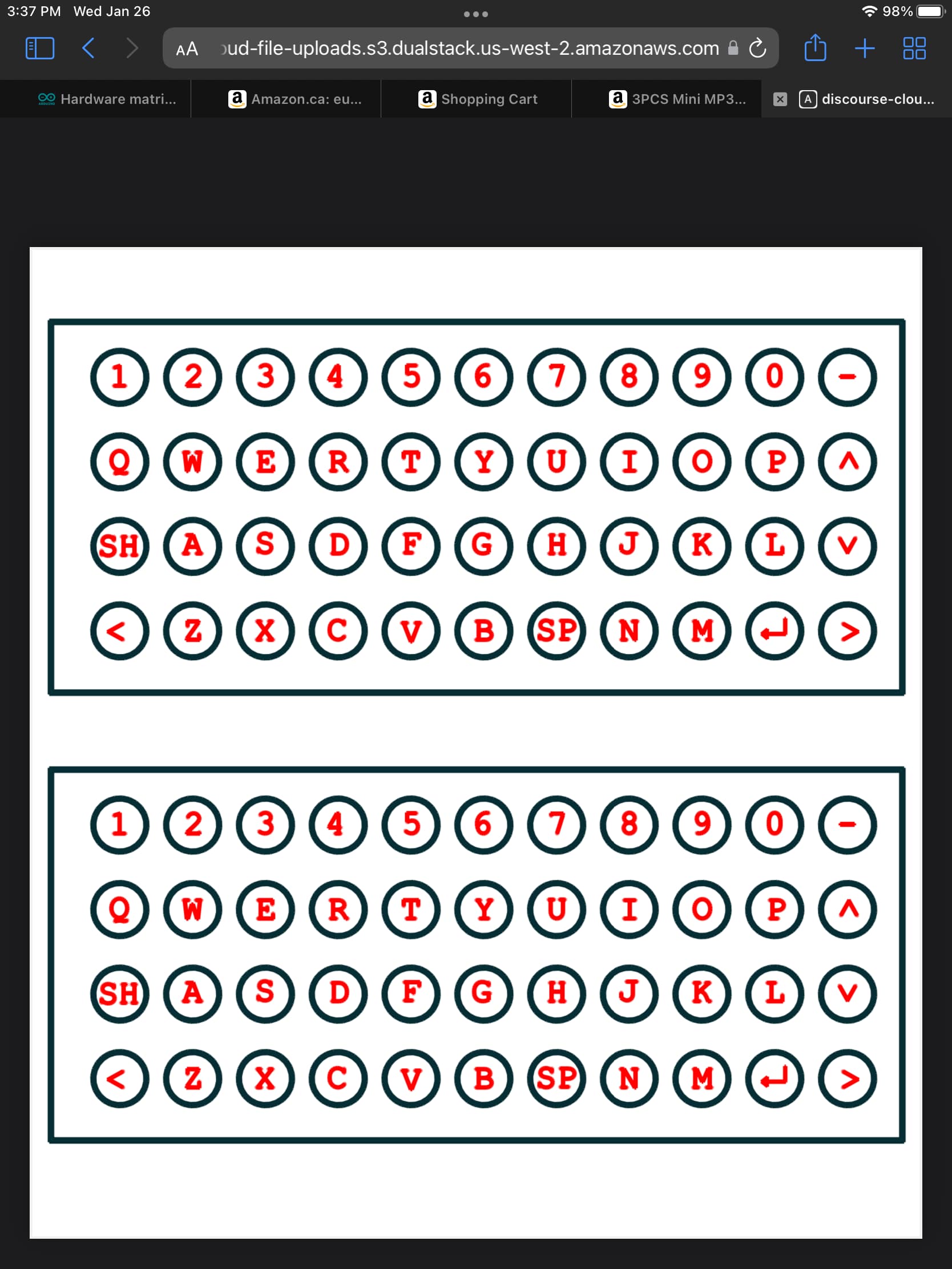

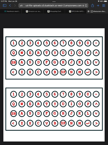

You can also use these, only needs one I/O pin.
//Is 44 button keypad overlay, Portrait or Landscape?
#define Portrait
//Portrait keypad definitions for the 44 button IR remote
#ifdef Portrait
const byte buttonCode[44] = {
  0x5C,0x5D,0x41,0x40,
  0x58,0x59,0x45,0x44,
  0x54,0x55,0x49,0x48,
  0x50,0x51,0x4D,0x4C,
  0x1C,0x1D,0x1E,0x1F,
  0x18,0x19,0x1A,0x1B,
  0x14,0x15,0x16,0x17,
  0x10,0x11,0x12,0x13,
  0x0C,0x0D,0x0E,0x0F,
  0x08,0x09,0x0A,0x0B,
  0x04,0x05,0x06,0x07
}; //END of buttonCode Array
const byte ASCIIcode[44] = {
  // 1    2    3    4
  0x31,0x32,0x33,0x34,
  // 5    6    7    8
  0x35,0x36,0x37,0x38,
  // 9    0    -   SP
  0x39,0x30,0x2D,0x20,
  // A    B    C    D
  0x41,0x42,0x43,0x44,
  // E    F    G    H
  0x45,0x46,0x47,0x48,
  // I    J    K    L
  0x49,0x4A,0x4B,0x4C,
  // M    N    O    P
  0x4D,0x4E,0x4F,0x50,
  // Q    R    S    T
  0x51,0x52,0x53,0x54,
  // U    V    W    X
  0x55,0x56,0x57,0x58,
  // Y    Z    <    >
  0x59,0x5A,0x3C,0x3E,
  //SH   NL    V    ^
  0xFC,0x0A,0x76,0x5E
}; //END of ASCIIcode Array
#endif
//Landscape keypad definitions for the 44 button IR remote
#ifndef Portrait
  0x4,0x8,0xC,0x10,0x14,0x18,0x1C,0x50,0x54,0x58,0x5C,
  0x5,0x9,0xD,0x11,0x15,0x19,0x1D,0x51,0x55,0x59,0x5D,
  0x6,0xA,0xE,0x12,0x16,0x1A,0x1E,0x4D,0x49,0x45,0x41,
  0x7,0xB,0xF,0x13,0x17,0x1B,0x1F,0x4C,0x48,0x44,0x40
  // 1    2    3    4    5    6    7    8    9    0    -
  0x31,0x32,0x33,0x34,0x35,0x36,0x37,0x38,0x39,0x30,0x2D,
  // Q    W    E    R    T    Y    U    I    O    P    ^
  0x51,0x57,0x45,0x52,0x54,0x59,0x55,0x49,0x4F,0x50,0x5E,
  //Shift A    S    D    F    G    H    J    K    L    v
  0xFC,0x41,0x53,0x44,0x46,0x47,0x48,0x4A,0x4B,0x4C,0x76,
  // <    Z    X    C    V    B Space   N   M NewLine  >
  0x3C,0x5A,0x58,0x43,0x56,0x42,0x20,0x4E,0x4D,0x0A,0x3E
#endif
