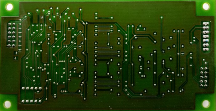

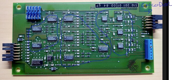

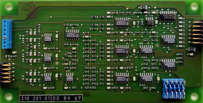

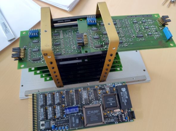

This is the existing circuitry - one board for each axis and a main controller.
Existing Circuits
And this is the sensor removed from the joint
Arm Joint
I would not know if the A to D coversion is done on the 6 circuit boards or if it would be integral to the sensor but the part number quotes 3600 line counts so it could be the latter
Does that help?
Regards
Mark

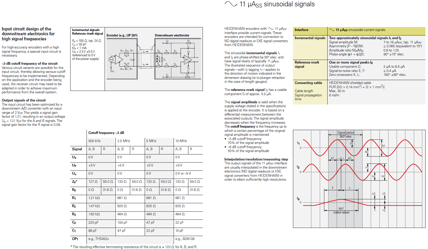

I found this on the heidenhain site - you were right in your first assumption about a differential interface
This is from the heidenhain interface info
And this is their differention interface box
Heidenhein EXE 101 Interface.pdf (891.2 KB)

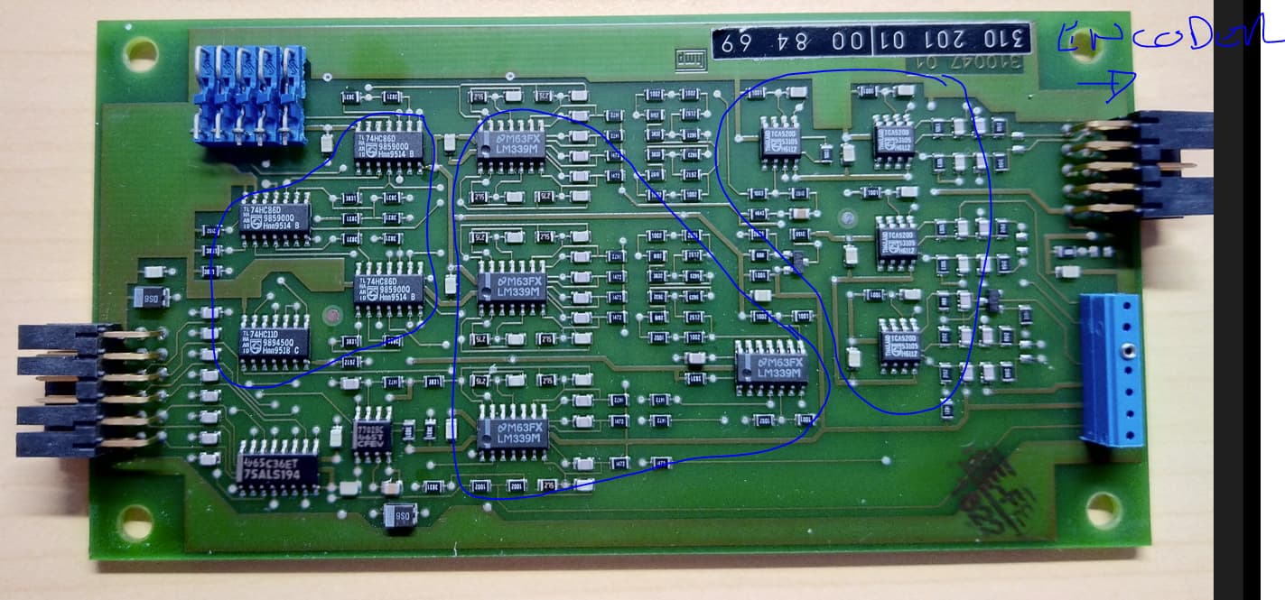

The existing board has 3 groups of 4 components, op amps, Xor gates etc - why would there be 4? could there be some redundancy?

Current output, that's interesting.
Looks like you have some work cut out for you :slight_smile:
The question I have is that it's not clear whether the sine cycle is from one "line" to the next or it's one cycle over the entire rotation. Heidenhein has a reputation for very high precision measurements, so there's a good chance that it's the former, since it would give the reader the ability to interpolate the position between lines. I haven't ever used one, but I do know that encoders like this exist.
Best way to proceed is probably to put a resistor across one of the output pairs, apply power and watch the voltage across the resistor with a scope. That will give you a good picture of what the output looks like.
Next step would be to build a differential amplifier for each channel using their document as a guide

Do you think it would be a good idea to try and create the circuit diagram for the interface board to undertstand what it does and then try and recreate that using more current components? Some of these function may be available as single chip solutions which were not available back in the 90's
No!
Let's take the 30,000 foot view here. Do any of the electronics work? Assuming that the goal is to make the arm usable and not just learn about niche encoders, using the existing interface would probably be the fastest path forward. Then you could read the output TTL signals with an arduino.
