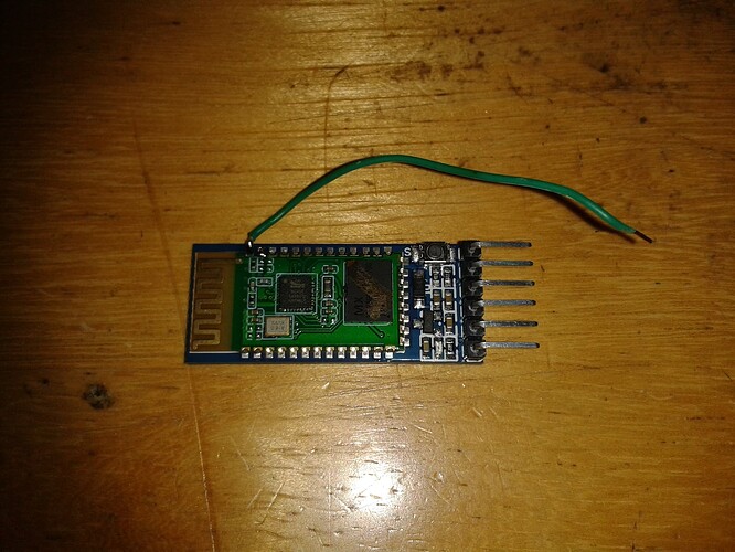

I have 2 HC-05 modules, I managed to get them into AT mode without issue, in fact i had some issues getting in normal data mode. The pulldown resistor on the board (10K) did not manage to pull pin 11 low, but after i soldered a wire onto it, and connected it to GND it went into data mode again (or at least not in AT mode, AT commands stopped working and the led started to blink fast )

The HC-05 has a BC417.
The HC-06 has a BC352.
And all the HC-05's get a gold check mark.
Yeah they do have that
I read
BC41C
Next to the 10K pulldown resistor for PIN 11 there is also a 2.2K, which is also connected to PIN 11, but doesn't appear to be connected anywhere else.
I haven't seen that config before - a different castellated board with the BC in that size.
Interesting, alibaba shows three versions. All I've seen / have are 'Original' (their term - on the right)
Like this one (2nd from left)
Ok so i got it working with 2 new modules, which do have persistent data, but through trial an error i came to the conclusion that it is actually the 'EN' pin being pulled up that puts the module into AT mode, and that normal 'data' mode is selected by powering up the unit while that pin is left free-floating. And that pulling it up during power disables the data mode.
This is still somehow different from what is described, but hey it works, i'm happy and can continue.
Still wondering what the button is for now though.
That is normal procedure.
The button does essentially the same thing but, for reasons I don't know, only the commonly used AT commands can be executed. See the Martyn Currey website.
