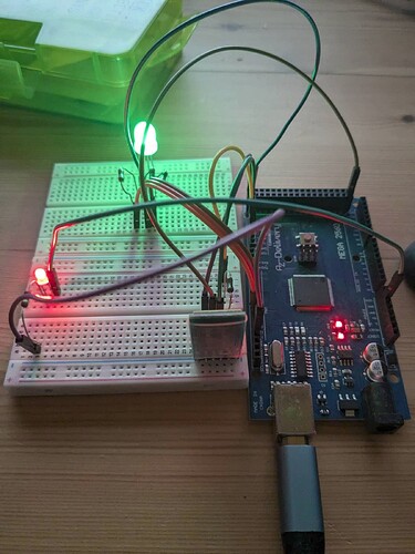

I'm trying to build a basic setup for bluetooth communication with my Arduino MEGA2560 (AZ Delivery CH340 clone). I'm using hardware serial1 and two LEDs to show me whats going on: One Common Anode RGB Led that mirrors the state of serial connection and one basic red LED that should turn on when AT Mode is entered.
This is the circuit:

What I'm doing/whats happening:
  • Disconnect VCC from HC-05
  • Upload Software to Arduino
  • Red LED flashes briefly, then goes dark.
  • RGB LED goes RED (on) then BLUE (serial with Arduino established)
  • Then I'm holding the button on the HC-05 and connect VCC
  • The HC-05 is blinking in it's 1sec on/of mode. So it SHOULD be in AT Mode.
But regardless of what I enter in serial monitor, both on 9600 and 38400 BAUD; I don't get any response on serial or from the LEDs. I tried "1" (without Quotes), "AT", "AT+VERSION".
Any Idea, what I'm doing wrong?

@corvin0
See something wrong here?
    // wait for the user to type "1" in the serial monitor
    while (serialByte !='1')
        if ( Serial1.available() )   {  serialByte = Serial1.read();  }
I don't get it @jim-p - the script is running until reaching the while where it's blocked until a 1 is sent.
So..."serialByte is 0. While serialByte is not 1, listen to Serial1 and write what you hear into serialByte".
The code should continue after the while loop is resolved and accept AT Commands, right? It's true that Id also set the Serial1.begin BEFORE that while, but that didn't change anything, already tried that.
The serial monitor is connected to Serial not Serial1, unless I mis-understand what you are doing.
"Normal" Serial on 9600 for Arduino to PC over USB Cable. And Serial1 on 38400 (default Baud according to the datasheet) for the HC-05 BT to Arduino over RX/TX (Ports 18 and 19).
Serial1 and Serial telling each other what they want is solved in the void loop:
    // listen for communication from the BT module and then write it to the serial monitor
    if ( Serial1.available() )   {  Serial.write( Serial1.read() );  }
    // listen for user input and send it to the HC-05
   if ( Serial.available() )   {  Serial1.write( Serial.read() );  }
Is there something wrong?
Yes. See post #4
The code I show is from your setup() section.
You are waiting for user input on Serial1
Aaaand we're green! A big thank you and sorry for drawing a blank :smiley:
