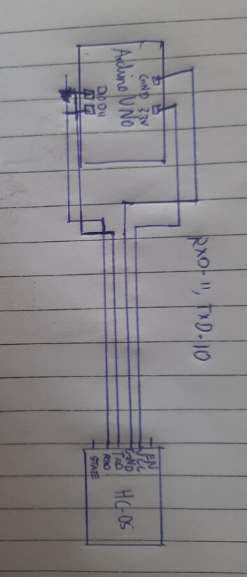

This is the wiring:

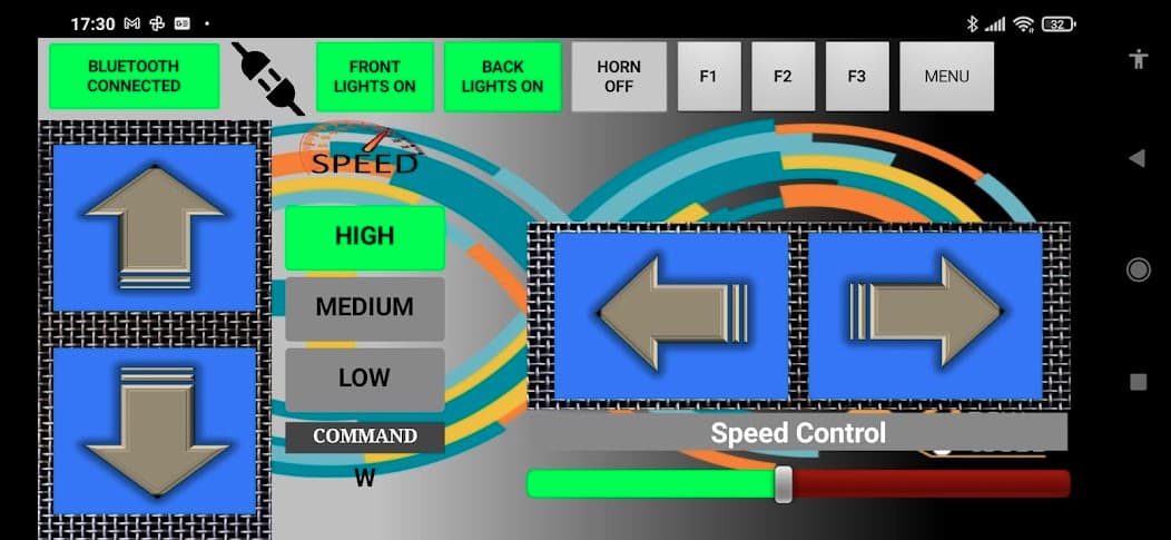

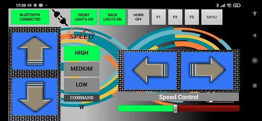

Did you click on "Bluetooth List" button and select the HC-05?
Do you see "BLUETOOTH CONNECTED" like in the above image?
I did exactly that but it shows the same error. It doesnt connect

Your drawing shows you have connected Bluetooth VCC to 3.3v. While this might work, it is clearly a bad idea, and could be the cause of your problem. Even if it isn't, you need to connect to 5v in the approved manner in order to avoid confusion. Further, while what you have is not likely to be fatal, it is good practice to have a 1k/2k divider in the Arduino Tx line, thereby having a 3.3v signal at Bluetooth Rx
AND, while I'm on the wiring bike... What sort of power supply are you using... I ask this particularly as it might be different from what you had while testing with a terminal.
I am using 2 li-ion to power an l298 driver, from that a wire is connected to the vin of the arduino. Since I am using an L298 driver, the 5V pin is already in use.
