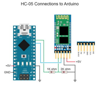

I am using Arduino Uno with an Adafruit motor controller shield, which unfortunately steals literally every single pin so I have had to modify it (hence why I believe my situation is "unique"). I cut pins 0 and 1 off and soldered some power pass through pins. So I currently have the pin that says RXD on the actual module itself plugged into 0, and the one saying TXD plugged into 1. I do not have a voltage divider installed, so the board is receiving 5V. I know that it runs on 3.3 and have seen that using 5V can be an issue however some guides insist that you can in fact use 5V, and they have wiring diagrams to support that.
