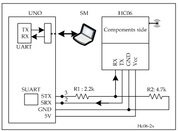

I recently trying to doing something with hc06 with arduino, as i tried to send data from serial monitor to android it works fine. but when i tried to send stuffs through the terminal on phone to serial monitor, it does not work at all.
Here is my code:

Your comments in the following snippet suggest (very sensibly) using pins 2 and 3 for Software Serial so why are you using pins 0 and 1? They are the pins for HardwareSerial
SoftwareSerial BTserial(0, 1); // RX | TX
// Connect the HC-06 TX to Arduino pin 2(as RX).
// Connect the HC-06 RX to Arduino pin 3 (as TX) through a voltage divider.
Leave pins 0 and 1 free for printing debug messages and for uploading programs.

@OP
1. The diagram of Fig-1 depicts the scenario of your present connection among BT06, UNO, and Serial Monitor.
Figure-1: BT06 connection using hardware UART Port
2. Based on the directives of Post#1, you should switch over to the following connections of Fig-2.
Figure-2: BT06 connection using software UART Port (SUART Port)
3. Upload the following sketch (your posted codes with slight modifications)
#include <SoftwareSerial.h>
SoftwareSerial BTserial(2, 3); // SRX = DPin-2, STX = DPin-3
char c = ' '; //initializes to a space
  Serial.println("Arduino is ready");
  BTserial.begin(9600);
  Serial.println("BTserial started at 9600");
  if (BTserial.available())
    c = BTserial.read();
    Serial.write(c);
  if (Serial.available())
    c =  Serial.read();
    Serial.write(c);
    BTserial.write(c);
Hi:
I just tried your connections, but when i switched it it became that the phone can send info to my arduino and when arduino sends infos the phone is not receiving and is not even able to be shown on the serial monitor

You need to post the revised program in your next Reply and also describe clearly how everything is connected. A photo of a simple pencil drawing showing all the connections will be best. See this Simple Image Guide

I have executed the setup/codes of Post#2 in my UNO-HC05-Android; everything works fine. A was sent to Android and Q received from Android.
Screenshot:
