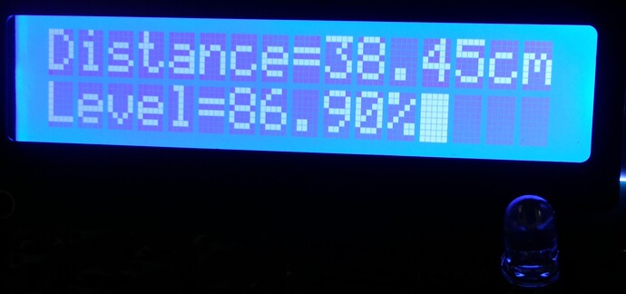

Sir , I am using the following code for distance measurement using HCSR 04 ultrasonic sensor, interfaced with Arduino Uno + LCD key pad shield,
I want to make an alarm if distance is less than say 25 cm
The alarm circuit can be driven by 5V
please give an idea to modify code , any of the Arduino pin can be configerd as "High" if distance is<=25cm
My code is as follows:-

Change duration to long instead of int otherwise it might overflow and declare a pin as output check the distance and set it HIGH if your reached your limit

const byte trigPin = 5;
const byte echoPin = 6;
const byte alertPin = 13;
    Serial.begin(9600);  // why do you want 9600 here? Can't that be faster? Where are you connected?
    pinMode(trigPin,OUTPUT);
    pinMode(echoPin,INPUT);
    pinMode(alertPin, OUTPUT);
    long distance,duration;  // don't declare as int or duration might/will overflow
    // Give a short LOW pulse beforehand to ensure a clean HIGH pulse:
    digitalWrite(trigPin, LOW);
    delayMicroseconds(2);
    digitalWrite(trigPin,HIGH);//TrigPin prepare high of more than 10us
    delayMicroseconds(11);
    digitalWrite(trigPin,LOW);
    duration = pulseIn(echoPin, HIGH);// echoPin received high start counting until the receiver to the low,return to the count value
    distance = duration/29/2;//Calculating the distance cm. Careful on integer rounding
    // The speed of sound is 340 m/s or 29 microseconds per centimeter.
    digitalWrite(alertPin, (distance <25)?HIGH:LOW); // turn on or off the alert based on distance
    Serial.write(byte(0x01)); // what was that capital X?? Why are you sending that 1 out?
    Serial.write(byte(0x80)); // 0x01 is "Start of Heading" and 0x80 is not standard ASCII would be euro sign in ISO Latin
    Serial.print("Distance=");
    Serial.print(distance); // use the right variables
    Serial.print("cm");
    delay(1000); // that's a bad idea you can bump into something within 1 second depending on speed

Sir, It is working fine as I expected, Thank you very much to solve my problem
VINOD
I am attaching photograph of my arrangement. Red LED become "on" as distance is less than 25 cm
Images attached
