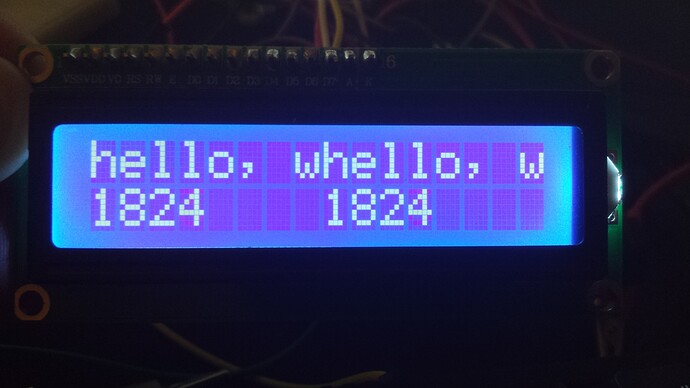

Hello,
I am using this LCD: http://www.amazon.com/Amerlight-TM-Module-Arduino-MEGA2560/dp/B00E5YJCBA/ref=cm_cr_pr_product_top
and this should be based on HD44780. I have it wired to my Arduino Uno per the comments section in the Arduino IDE Liquid Crystal example sketch, "HelloWorld". The problem I am having is that after 8 characters, the characters start to repeat as shown in my attachment. I haven't been able to find anyone with a similar issue. I've tried shortening my jumper wires to see if it was just a signaling issue, but this didn't work. Any other thoughts on a fix would help.

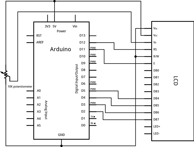

We need to see your wiring (show us an image of) and your code.

Try running the following sketch and see what the sequence of events is. Specifically, does the problem occur (I think it will) and if so do the duplicate letters appear on the display at the same time. Increase the intercharacter delay if necessary.

Wiring follows attached scheme.

Yes, the duplicate characters appear and at the same exact time.
I would say that your module is defective.
One of the blobs on the back is the main controller which contains all of the memory along with the circuitry to display the 16 characters on the left half of the display. The other blob is an auxiliary controller which contains the circuitry to display the 16 characters on the right half of the display.
One possibility is that there is some miscommunication going on between the two controllers that is most likely due to a damaged controller or a damaged trace (or traces) on the pc board.
Another possibility is that there is a problem with the memory addressing within the main controller whereby the information for one screen location is being stored in multiple memory locations. In either case you need a new display.

There are some scrapes across some traces on the back, but I didn't think they were deep enough to affect the copper. Also, there are scrapes on the top layer (where the lcd assembly is mounted), but they don't seem to cross traces. They are just between pins that I soldered. I wonder if I can repair it somehow.
