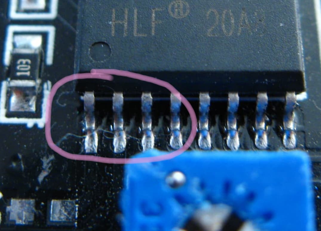

In one of your photos, it looks like there may be some kind of trash laying across the first 3 or 4 pins of the PCF8574 chip. Perhaps a piece of thread, or a very fine wire?
Pins 1,2, & 3 of the pcf8574 chip are the address selection pins.
Have a close look at this area of the PCF8574 chip to see if you see anything.
A few years ago there was a case of tiny threads laying across a couple of LCD pins (not the PCF8574 chip) which caused the LCD to not work. Once the threads were cleared away, it worked properly.

Yes a strand of dog fur from my dog. I blew it off and it still doesn't work when I reupload that code.

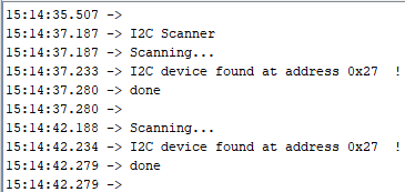

What happens when you run the i2c_scanner sketch in the Wire library?
Does the issue go away if you hard code the address?

Yes. Works beautifully.

About the only difference between the scan done in the sketch by I2CexpDiag and the i2c_scanner vs the scan done in the library is the scan in the library starts much quicker in the library since the sketch will have several 10s of milliseconds between the call to Wire.begin() and the scan starting.
vs in the library it is immediate.
Also the scan in the library only scans the addresses of the PCF8574 chips vs the sketch scans are scanning all the addresses so there is quite a bit of additional time before reaching the addresses for the PCF8574.
Just reaching at straws but it can take a few milliseconds before the pullups on the i2c bus signals charge up. The Wire library should ensure that the bus is ready to use after Wire.begin() is called.
Or perhaps that particular chip has a longer amount of time to be ready to be addressed after the bus glitches during the Wire library initialization.

Photo #3 in post #2 shows a regular PCF8574T backpack with 4k7 pullups and address 0x27.

Edit. There is something odd about the photos in #2.
The soldering all looks good. But I have never seen a backpack with a straight 4-pin header.
They normally have angle headers. Easy for Duponts but no good for breadboard.

That's because I unbent them.
