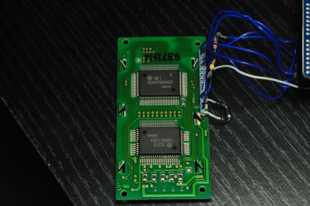

Hi, I'm new to the arduino and this community, I found one of these screens and I was trying to follow this tutorial http://arduino.cc/en/Tutorial/LiquidCrystal but all I get are these weird characters you can see in the attached images.
Instead of using a potentiometer (which I don't have at hand right now) I followed this tip I found here http://www.arduino.cc/playground/Code/LCDpot
Instead of using a potentiometer for the contrast setting you could use a diode and a 10K resistor. From pin 3 of the display put a diode (1N4001) to ground (pin 1 of the display). Ring on the diode should be oriented to ground! And put the 10K resistor from pin 2 (Vcc) of the display to 5V supply voltage. On several displays this gives a perfect contrast. If not then use the above mentioned 10K potentiometer. Why this is working: Measuring the voltage at the diode will give 0,65 V. And this is exactly the optimum for contrast on most displays.
I tried using others than the standard lcd library on 0022 with no luck (I'm using an arduino uno).
I also tried adding delays in several parts of the sketch, now I can see those characters better and not so dim, but the problem remains the same. I even tried powering the screen with 3 and 4 AA batteries but it was the same.
Can you see anything wrong with the wiring?
I didn't have a 10k resistor so I used three in series which add up 10k, the diode is a 1N4007
Thanks a lot!

Your pictures are very small and didn't show well which pin is connected to which pin. Suggest you get better pictures. Plus, please use a potentiometer.
Hi, here you can see higher res photos https://picasaweb.google.com/juan.ferrarib/ArduinoLcd?feat=directlink
On photos 1, 2 and 3 the pin 1 on the display is the one on the right.

It's not the same. You didn't ground pin 1 and the tutorial did. Plus, why did you connect VDD or lcd pin 2 to 3.3V on arduino and had those resistors in series. Which part of that adafruit tutorial told you to do that? :wink:

lcd pin 2 is on 5v on the photos, check photo #2 please.

What are those resistors soldered together doing?
That is addressed in my first post.
Thanks.
Got it. Remove them, connect lcd pin 2 directly to 5V. Also connect lcd pin 1 to gnd. Get a 10K potentiometer or limp on with the diode (OK for now). You have NOT followed closely to either tutorial, cause both said exactly what I just typed up.

Besides the potentiometer, lcd pin 1 needs to be grounded. lcd pin 2 to 5V directly instead of resistors. That's 3 times I said it. Why can't you read my replies.

Yes, same reason, you don't know. I asked you several times why there are several resistors on lcd pin 2 and you still have not answered me why. They should not be there. That is the answer. But I don't think you agree with this answer. You think you did everything correctly and according to the tutorial but you were wrong. Besides, the ground was not connected and you used a half-baked, now-evaporated tutorial instead of getting the potentiometer (I believe this part you start to agree with me now).

I suggest that you disconnect everything and start again. First connect pin 1 directly to GND, connect pin 2 directly to 5v and if you don't have a pot try (a) connecting pin 3 directly to ground or (b) connecting pin 3 to ground via the diode as you did before. At this point you have not connected any data lines or run any sketches. You should have the display shown about halfway through the Adafruit tutorial, just before the 'Bus Wiring' section (except their picture is upside down). Don't continue until you have the single row of black boxes.
