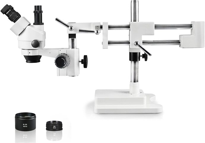

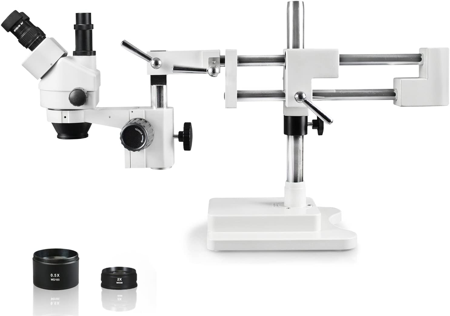

Get these in order:
And/Or

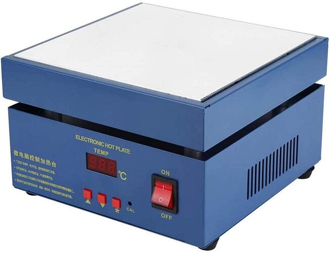

  • When it comes to a board of components, the PCB needs to be heated/soaked/reflowed: this is not the job of a hot air wand.
  • A soldering iron heats up components leads very fast (less than two seconds), a hot air takes significant time.
  • A hotplate (like the MHP-30) can solder a board section in under 20 seconds.

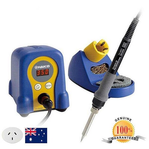

That is definitely missing. Mines a set temp 400ºC clunky horrible thing.
Maybe I'll save up for this:

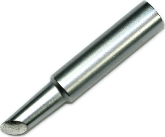

In order, these are my favourite tips for that iron:
A
