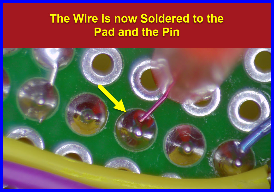

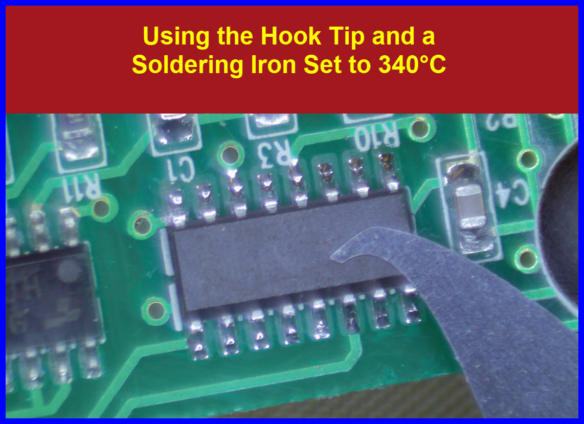

  • Save up and buy a better quality iron.
    Quality is important when buying a soldering iron.
    If you will be doing a lot of future work in electronics, a good iron will be the best investment.
  • I have used the FX-888D for many years, does everything I need.
FYI

I've worn out the scrolling wheel on my mouse... :smiley:
Good info.
