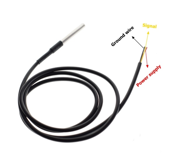

Water doesn't boil at 40C.
Use a DS1820 sealed sensor, easy to interface and use.
Google arduino DS18B20
