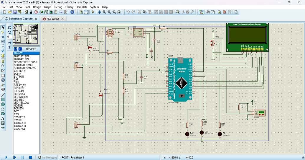

Hello,i need some help with code and circuit to do a circuit to calculate SOC using coloumb counting in arduino
what components do i need and how do i code it

If you search 'coulomb counting ic' you can find several ic that does this for you ( also these are low power circuit ).
If you want to implement 'in software' ( but some hardware is needed too ) you need:
  • a current mesuring circuit, in both directions ( as you need to count the current charging and discharging, I imagine )
  • some eeprom to store the accumulated count ( or you'll lose it when you lose the power )
  • some low power arduino ( if you need to measure the charge of a battery for example )
To calculate the charge, simply sum I * dT where I is the istantaneous current read and dt is the time between two successive conversions ( so 1 multiplicatio and 1 summation every cycle ).
A smarter method is to sum only the values read from the ad, the counts ( only 1 summation per cycle ), the conversion to charge is done only when necessary ( es 1 time per sec ), this implies that conversions are done at an exact rate ( right hardware needed ) the result is also more accurate.

Put together a preliminary schematic showing how you plan on assembling this and post that, we will check and comment on it for you. You may not have the parts correct, that is why it is being posted and commented upon.

this my main project that iam trying to simulate but the main issue i dont know how to implement the coloumb counting on the code
maybe i need to add another current sensor or change somethin
i can send you my code but its kind missy i didnt put the coloumb counting equation in
Post the code; the screen shot of your schematic is hard to read, most of the part numbers are not readable. Try posting it in PDF format. You should have R1 connected to the processor port not the MOSFET as it is forming a voltage divider starving the gate drive. R6 and R7 will deplete the battery fairly quickly.

  • I wouldn't use an irfz44n as it is not logic level, if you want to use a monster like this use the irlz44n ( it is 47A )
  • the acs712 is analog so you'll convert its value via the arduino adc ( 10 bit ) 1lsb = 1/1000 FS, so not super accurate
can i get some more details ?
because iam really confused
i dont need that much accuracy i need to figure it out if is it possible to work through this code and circuit to get coulomb counting working
  • added global variables
unsigned long prevConvTime = 0;
float totalCharge = 0;
  • in function read_data totalCharge is calculated ( in coulomb if bat_amps is in Ampere )
totalCharge += bat_amps * (currConvTime-prevConvTime)*0.000001;
( the multiplication by 0.000001 could be omitted, in these small processor the less floating point arithmetic the better, in this case multiply by 0.000001 before using es:
float tc = totalCharge0*.000001;
Serial.print(tc);
P.S.
This value is always incremented and never resetted, is this ok?

Hi, @huuh
Welcome to the forum.
Rather than a screen capture;
You should find on the CAD an EXPORT facility, this will make a higher resolution image for us to read.
Look under the "Files" tab.
hope it will work on this simulation even i see it as a faillure
and i see that iam confused more lol i missunderdand this circuit
i did try to send it as pdf file but iam kind new user so dont have the right to send attachements
