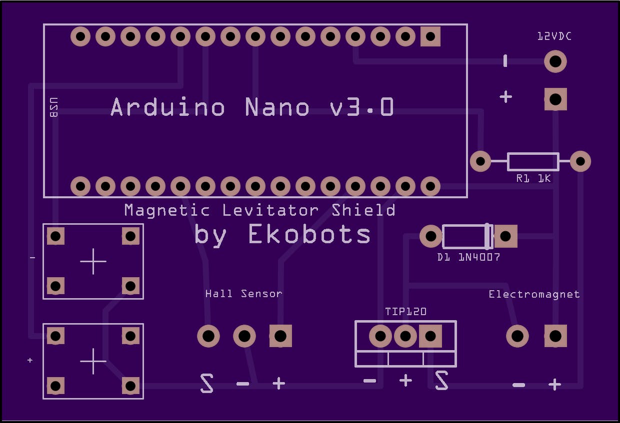

I am very inexperienced with electronic circuits and this is my first arduino project. I am having trouble with the schematics I am following for a project. [Magnet Levitation with Arduino - Arduino Project Hub]

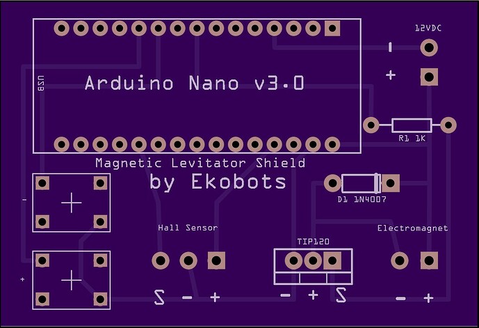

The schematic shows two power supplies, but the parts list shows only 1. The schematics are represented differently in the fritzing diagram and the shield. I am not buying the premade shield and building this out on a breadboard. I am not understanding how to route a single power supply to both the electromagnet and the arduino.
Look at the circuit board image! It shows only a single connection for the power supply. So only one is needed. It connects to both the magnet and the Arduino. Very poor design, but it is what it is.

That means ANY voltage between 5 and 12 can be connected there. That is WRONG because the lower limit for the Arduino power on that pin is about 7 volts. Makes the rest of the project potentially have errors.

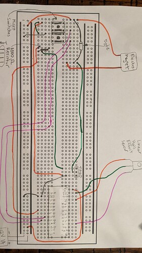

Ok, so I hooked everything up. I had an old wall power adapter that is 12v, 1A output that I used for the power supply. I just cut the wire and hooked it into the power rails on the breadboard. When I plug in, the led on the arduino lights up. I have not tested functionality yet. I noticed that the transistor was getting hot. I put a temp guage and it goes from 75 to 100 in about 10 seconds so I unplugged it. Transistor is rated to 5 A and 100V. I have the B terminal of TIP122 going to the brown side of resistor, C-terminal to the side of the diode without a line and E-terminal to ground. I am unsure if I have the diode configured properly on the breadboard. I have the diode between the leads of the electromagnet and the leads to positive rail/TIP122 C terminal(2 leads and 1 side of diode on each of two two terminal strips). Does it matter if all these are together on each terminal strip?
I noticed that I had pink lead of Hall Effect Sensor previously going to the ground rail. I moved to A1. Transistor still getting hot after move. Perhaps the switches? I drew in the bars that are on the backside that seem to indicate some kind of internal connection. The switches make adjustments to electromagnet. Notice how it is represented differently on the Fritz and the Shield? Is there a short?
I have a DMM. Vin and GND pins are connected to rails. Does it matter that I used two different GND?
I mean there are two GND on the Arduino and I utilize them both randomly. As shown on diagram I connect one of the GND of Arduino to common rail on breadboard. Are grounds all good on diagram?
