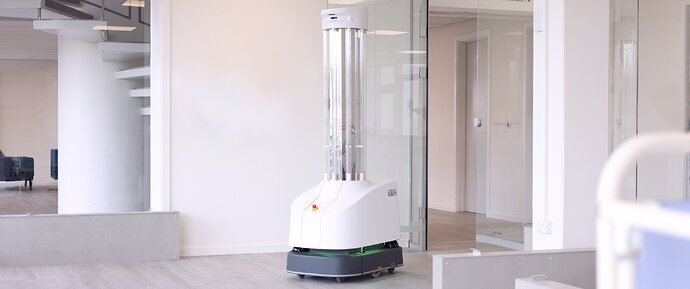

I am from London and I need your all to help on design UV robot. My task is to build robot which disinfects the supermarket shelves. The idea is to build robot which drives around the store at night while shop is closed and sterilize all the shells using UV-C light lamps. The same like in hospitals but simple and cheap :slight_smile:
Something like that :
. While I need to get it done very quickly I have no time to research what is best and easiest to use and guys any suggestion for me is life saving :slight_smile:
So tasks is to what I can see, it just first ideas but I need your opinion in any single of them.:
  1. Robot needs to drive itself by coordinates (GPS mostly bad inside the supermarkets) .Needs to move from point A-B-C-D..... etc.
  2. IR sensors to avoid unexpected objects probably is important but maybe is it not necessary as the shop before closing at night could make sure that there is no obstacles. (because time ands cost are mandatory in this project)
  3. Robot will drive in easy ands flat shop surface but need to care 6 UV lights, which are light in weight but are long in height (about 1.5-1.8m) so I am thinking the rides should be wider as usual adruino robot to prevent falling on corners.
  4. Robot needs to drive it self for a ~2 hours and support 6x8w lamps
