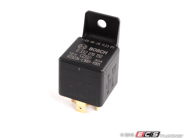

i need 30A relay

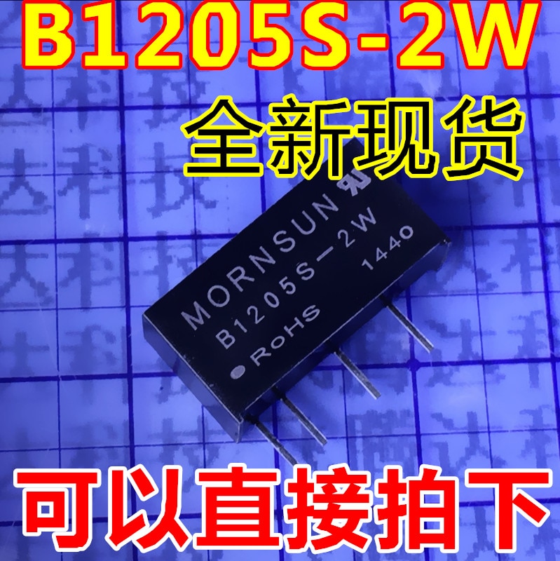

Not sure about the B1205S. Seems unregulated. Bad for LiPo.
The other (USB) chargers also won't work, because they rely on USB common ground
Leo..
you have to mix it, use the inestable 5v ISOLATED to power up the usb charger with diferent grounds
that is my most easy way because is so simple, but i prefer to forgot it for know, i cant regulate maximun V of charge and B1205S has really bad eficiency (71%) and low max current (200ma to charge 12000 mAh aprox)
