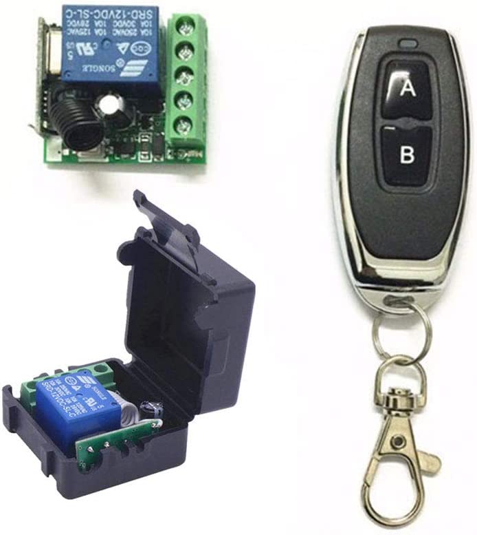

  1. Transmitter :
  1. Receiver :
  • relay module included in above transmitter

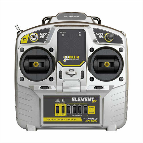

You could do this with a standard Radio Control setup, no Arduinos needed at all.
Think RC transmitter with a switch to lower a model aircraft landing gear, or raise wing flaps.

Thanks. So is the " DC 12V 1CH Relay Receiver Module RF Transmitter 433Mhz Wireless Remote Control Switch 12V Single-channel Wireless Remote Control Switch" (see first link in description) that has a transmitter and a receiver is sufficient?
The only thing is how can I tell the servo to rotate to a specific point and stop.
I won't be able to see what I'm doing as I'll be in another room. The press of switch A must open fully (180 degrees) and the B switch to close fully.
No.
That simple RC switch wont directly control a servo.
Ahhh that's such a shame. I thought it would give the signal and activate the servo linked to the receiver.
Do you mean something like that:
Sorry I'm so totally clueless!
Something like that.
Its got switches, which can probably operate servos and the transmitter can probably control the servo travel end points too.
I see thanks! So much more expensive though.

Remote control ("garage door" or similar) transmitter/ receiver pairs are readily available as are cheap servo tester modules. You hack the latter to set two servo positions according to the relay from the remote control.
No Arduino required.

Aren't "Remote control ("garage door" or similar) transmitter/ receiver pairs" similar to this?:
Would you have a link on how to hack that to set the servo at two different position? Sorry, I don't even know where to start looking :sweat_smile:
