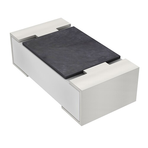

It is a capacitor (C6). Murata GRM155R61E105KA12D
The Digikey part number is 490-10017-1-ND:
The official board design file does not match your board perfectly, but the component in that location on the design file is R5, Yageo RC0402FR-074K7L
The Digikey part number is 311-4.7KLRCT-ND:
I think it will be easy to find this part. You don't need to get the exact replacement. Just make sure to find a resistor of the same size and resistance and you'll be fine. It is a very common and cheap part that any major electronics supplier should have in stock.

C6 = 1 µF ±10% 25V Ceramic Capacitor X5R 0402 (1005 Metric)
R5 = Resistor 4.7K OHM 1% 1/16W 0402
Keep in mind, these parts are 1.5 mm X 0.5 mm (looking at the board). You should have a soldering iron tip no wider than 0.5 mm (or maybe a little bigger if you are good at soldering).

will this work as a for a replacement of R5? Do I have to keep in mind the quality and the actual error/tolerance? I dont think so, because it is apparently just a pull up resistors.
