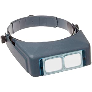

Then buy yourself one of those magnifier headbands http://www.amazon.com/Donegan-OptiVisor-Headband-Magnifier-Magnification/dp/B0015IN8J6
