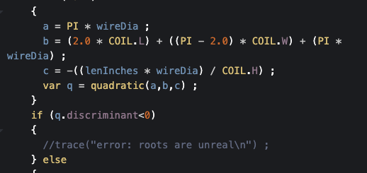

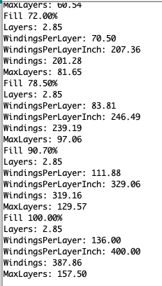

Hi! I'm currently attempting to take a JS program (visible on codepen.io) and bring it into the Arduino C/C++ environment, whatever it's called officially.
I'm pasting the Arduino program I managed to come up with, you can see it's just meant to take some dummy numbers (already defined variables that'd normally be user-entered) and perform the calculations, then print them into the serial monitor for me to double check.

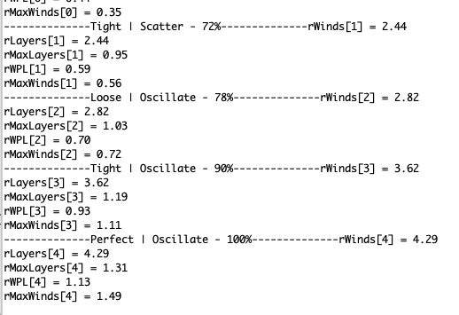

Right now I'm getting a lot of zeros and I'm certain that most of the problem arises from the quadratic equation where the bobbin's core size and the winding area are calculated. And also stuff that references back to that quadratic pile, like this:
COIL.layers = ((q.r1 < 0) ? q.r2 : q.r1) ;
I just don't know how that's supposed to look in C, I have it written out as a bool statement...regardless, it's no help if I'm not getting any meaningful answers out of the quadratic equation.
Anyway, I'm just hoping someone here who did better in math class can help me work this one out...it's been bothering me for a while now

Serial.print("--------------");
Serial.print("Loose | Scatter - 62%");
Serial.print("rWinds[0] = ");
Serial.println(rWinds[0]);
Serial.print("rLayers[0] = ");
Serial.print("rMaxLayers[0] = ");
Serial.println(rMaxLayers[0]);
Serial.print("rWPL[0] = ");
Serial.println(rWPL[0]);
Serial.print("rMaxWinds[0] = ");
Serial.println(rMaxWinds[0]);
Serial.print("Tight | Scatter - 72%");
Serial.print("rWinds[1] = ");
Serial.println(rWinds[1]);
Serial.print("rLayers[1] = ");
Serial.print("rMaxLayers[1] = ");
Serial.println(rMaxLayers[1]);
Serial.print("rWPL[1] = ");
Serial.println(rWPL[1]);
Serial.print("rMaxWinds[1] = ");
Serial.println(rMaxWinds[1]);
Serial.print("Loose | Oscillate - 78%");
Serial.print("rWinds[2] = ");
Serial.println(rWinds[2]);
Serial.print("rLayers[2] = ");
Serial.print("rMaxLayers[2] = ");
Serial.println(rMaxLayers[2]);
Serial.print("rWPL[2] = ");
Serial.println(rWPL[2]);
Serial.print("rMaxWinds[2] = ");
Serial.println(rMaxWinds[2]);
Serial.print("Tight | Oscillate - 90%");
Serial.print("rWinds[3] = ");
Serial.println(rWinds[3]);
Serial.print("rLayers[3] = ");
Serial.print("rMaxLayers[3] = ");
Serial.println(rMaxLayers[3]);
Serial.print("rWPL[3] = ");
Serial.println(rWPL[3]);
Serial.print("rMaxWinds[3] = ");
Serial.println(rMaxWinds[3]);
Serial.print("Perfect | Oscillate - 100%");
Serial.print("rWinds[4] = ");
Serial.println(rWinds[4]);
Serial.print("rLayers[4] = ");
Serial.print("rMaxLayers[4] = ");
Serial.println(rMaxLayers[4]);
Serial.print("rWPL[4] = ");
Serial.println(rWPL[4]);
Serial.print("rMaxWinds[4] = ");
Serial.println(rMaxWinds[4]);
