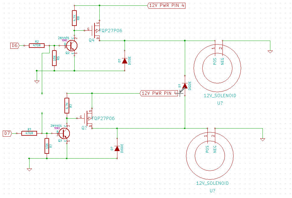

So after installing the diode the circuit has been running for about 2 hours with a 1 sec on and off time and so far no damage to any components.

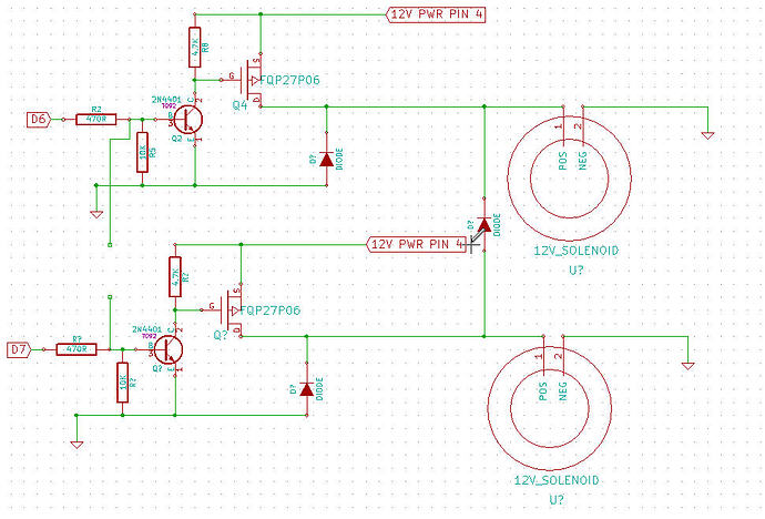

Now I have attached another drawing to show a different route for controlling the two solenoids
I have moved it between the two drains...my thinking is if pin 7 MOSFET is on it will also feed the other solenoid, but if PIN 6 is on it only feeds the one solenoid.
Also I'm using a 1N4000 diode for all diodes in the drawing.
let me know what problems I may run into if I go this route but at least the MOSFET's are staying alive
Thanks again for all the info

Mosly when diodes fail, they remain shorted. Either your 1A diode is by chance holding up quite well, or it has now forgotten how to turn off.
If the circled diode has failed, input D7 will still control both solenoids, but so will D6.
Hi, you should be using software to do what you are trying to accomplish with the extra diode.
This will apply less stress to the hardware.
Tom...... :relaxed:

this is why fast diode and not standard slow 1N400x are required. because the high back EMF voltage from the coil kill the transistor before to be damped by the diode.

It certainly should be working in that case, but the question we must now ask is - where was the diode before?
dark1990:
No, that is very bad. That will mean one transistor will be powering both solenoids in parallel at some stage, which will be stressing it excessively and unnecessarily. Better to use the circuit dlloyd illustrates, though his explanation is confused or confusing.

I sure hope not! A 1N4000 is an obsolete stud-mount 7.5V 10W Zener diode. Care to explain what you really mean??
I bet he meant to say one of the 1N4001-1N4007 family
I see someone touched on a opto coupler. Would this really be the way to go? I can also switch out the transistor for a opto just not sure which one would work best.
It was TomGeorge, and it really is the best way to go. Some parts I would suggest using are PS2501-1 and 1N5408.
From the specs, it's a bit overkill, however these parts are readily available and not very costly.
As a suggestion, here is the opto-isolated circuit:
  • IN4001 to 1N4007 diodes would also work ... there's no extra cost to get higher blocking voltage, i.e. 1N4007.
  • Do not connect GND5 to GND12.
So I didn't make it clear enough in my first post. I kept smoking MOSFETS (10 to be exact) without the diode. I then read and researched MOSFETS and inductive loads I then came across the flywheel diode.
I then placed it in my drawing. Before I added the diode I posted on here to make sure it was in the right spot as I had only 1 MOSFET left before I needed to order more.
Once you guys said it was correct I tried it with success. I then wanted to know if I needed to add anything else to protect it further.
I also meant 1N4001 sorry about the typo but I will place a larger one in the final design.
I will change the code and remove the diode from the two solenoids source.
I did run the circuit for 6 hours straight and the only issue I had was the solenoid got extremely hot. However the solenoid is not designed for long durations so for my purpose it will work just fine. They may operate 5-10 min in a 8-10 hour period
I may try an opto circuit for the isolation alone since I aslo need to do a N channel MOSFET to control a 36v circuit on the same board.
Thanks for all the suggestions and tips
