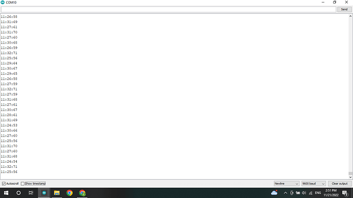

I'm currently working on a project where I will send DHT11 and SW420 sensor data use RS485 Module from slaves 1 and SCT-013 sensor data from slave 2 (slave using Arduino Nano) to the master (Arduino Uno). Here I use the modbus RTU library from GitHub - smarmengol/Modbus-Master-Slave-for-Arduino: Modbus Master-Slave library for Arduino .
When I run the system, the data from slave 1 cannot be read by the master while the data on slave 2 can be read by the master.
I feel this is problem in pointer, I don't understand about modbus, please help me to solve this problem.
thanks

Serial Monitor From Slave 1
Serial Monitor From Master
