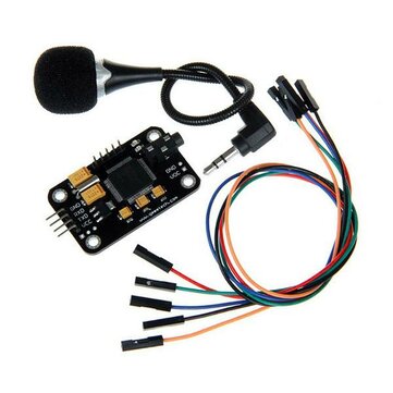

here use this!
its a module for Arduino and other microcomputers
there a lot of videos about this module on yt
