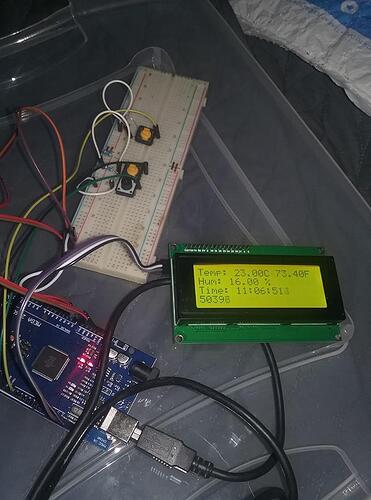

Sure that's no problem, never got used to working with cad so I can dl a pic of a breadboard and post it after editting it.
I will also refer to rule 7 for posting code, thank you for not instabanning me for my ignorance in reading rules. I just like to ask questions and learn, never mean to impose.
LCD is hooked up in standard format
DHT11 is connected to negative and pos at breadboard and A0 on the Mega
Buttons are connected to digi pins 2,3,4. 10k resistor connecting one corner of button to neg of breadboard.
Sorry for my poor mspaint craft

I should of downsized my last working program down to the most efficient code for myself.
After studying the 3 menu examples I admire for different things I finally know what I believe i'd like for sure. The EEEuthusiast example code with a switch statement similiar to the pastebin switch statement in the inputAction section.
The parameter variables/ last 2 elseif statements get rewritten so when the desired menu page is selected it can refer to the switch to direct the user.
The screens variable gets rewritten to this format screens[numOfScreens] = {"Item1","item2","item3",...}
printScreen along with anything else gets edited to support the extra 2 lines.
Buttons 3 and 4 would be defined in the switch statement to adjust local variables
I will try my best to dry a schematic of the arduino side later on today after trying to figure this out a little bit, took me a lil long just to do the breadboard pic which unfortunately cut my diagnosing time short.
The arduino side is super simple though, just a I2C LCD connected to pins described in the program and DHT11 at A0 then the 3 buttons which I have to add another one to.
I am open to changing anything however as suggestions are nice. Been doing this in small steps so hopefully this can turn out how I wish or how I'd like.
If I had a dead set circuit I would of been sure to of include it but for now my circuit can still change, the option of putting multiple buttons to 1 analog pin is very attractive, so its not completely off the table yet since I don't know how many more pins will be getting used with other hardware that I'd like to add like the SDCard, Wifi, and other misc sensors.

Ok so the menu displays; >Display v
Temperature
Relays
Fans
Only 2 buttons of the 4 work, I can only go down one to Temperature or the other button refer's me to a case 4 and says Yellow ON...
Need to fix it so the cursor can go all the way down and up and be able to select each option.

Knew it could be done with 3 buttons, but if I would like to return to the mainscreen on my own input, I would have to add a 4th button and put it to update the menu.
Still a problem unfortunately!
I just dont get this.

I'm sticking to this code, due to its simplicity. My problem is local to the loop statement.
If I swap downButton, menu-- for upButton menu++ the menu will automatically go down or stay at the top but only the selectButton works at the moment.
