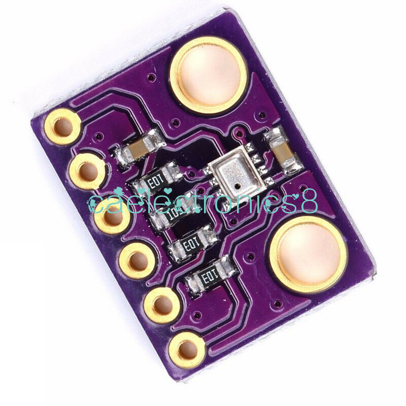

Is there anyone who has Arduino air pressure sensor. If so can I work online to check some thing ( To detect when someone inhale) Currently i have no access to go out door to buy a sensor.
The sensor in question would presumably be the BMP280.
I would be reasonably certain that this will assess respiratory pressures entirely adequately for the task. It is an absolute sensor, so you would use a pair, one for ambient and one for circuit pressure.

The design plan is attached. I need the support for PS1 sensor. (BPM280 or other) This sensor should detect when the pressure drops when try to inhale and trigger.( ie. AC230v relay switch for v1 solenoid valve open and v2 close)
