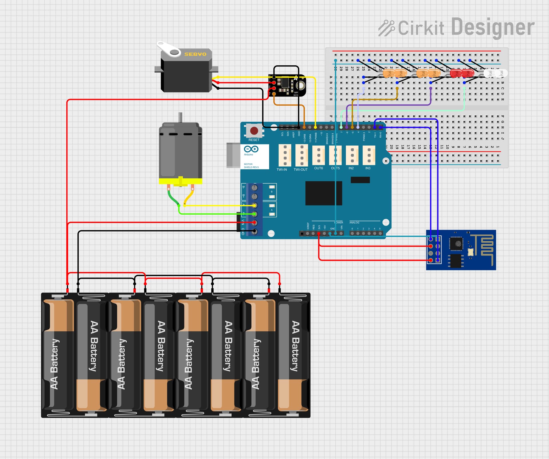

8 cells giving 9.5V means they're pretty much dead - if that's the problem.
Try some fresh batteries, but if they also put out only 9.5V, immediately remove them from their holders and correct the wiring error.
So i tried with 8 new fully charged AA batteries but i still get the stuttering from both the servo and dc motor.
You made all the corrections from post #29 ?
What's the voltage across the power supply with no load?
yes
11.52v
Check the voltage at Vin and GND on the motor shield
around 10.8v
Also, it's time to post your code so we can see what you are doing.
In the IDE under the EDIT menu item, click on "Copy for Forum" then just paste your code here.
Yep, will do when I'm home.
Right now I'm trying to hook up 8 LEDS for brake lights, front lights and blinkers for front and back. I'm having some trouble with the servo being delayed by the blinkers delay and of course the weird battery stuff. Also, I use RemoteXY to control everything.

Could it be the LED drawing too much current because without them the servo and motor work just fine. If so, is there a way I could make the LEDs draw less current.
Depends. It's not clear what kind of LEDs you're using.
Your diagram shows regular 5mm LEDs but without a current limiting resistor:
If this corresponds with reality, then that's not a good idea and problems can be expected.
However, there's also some of this in your code:
If that amounts to a 500ms delay, then that might be a big part of your problem, too.
Without specific information on your hardware or full code, it's going to be difficult to recommend anything.
Yes they are 5mm leds but do i need resistors for them? They have worked so far. Edit: "Oh yeah current limiting with resistor"
My hardware is
Arduino Uno Rev3 + Motor shield Rev3 (5v, 50 mA max)
DC motor (12v, 726 mA max)
Micro Servo (4.8-6v, 240 mA max)
ESP-8622 (3.3v, 170 mA max)
SparkFun BabyBuck Regulator 5v
8x 5mm LEDs
8x AA batteries in series (12v, approx. 2000mAh)
What do you mean about full code? I sent it, that's it.
I put some resistors on the LEDs and now it works, thanks :). The only thing now is to get rid of that delay on the servo.
