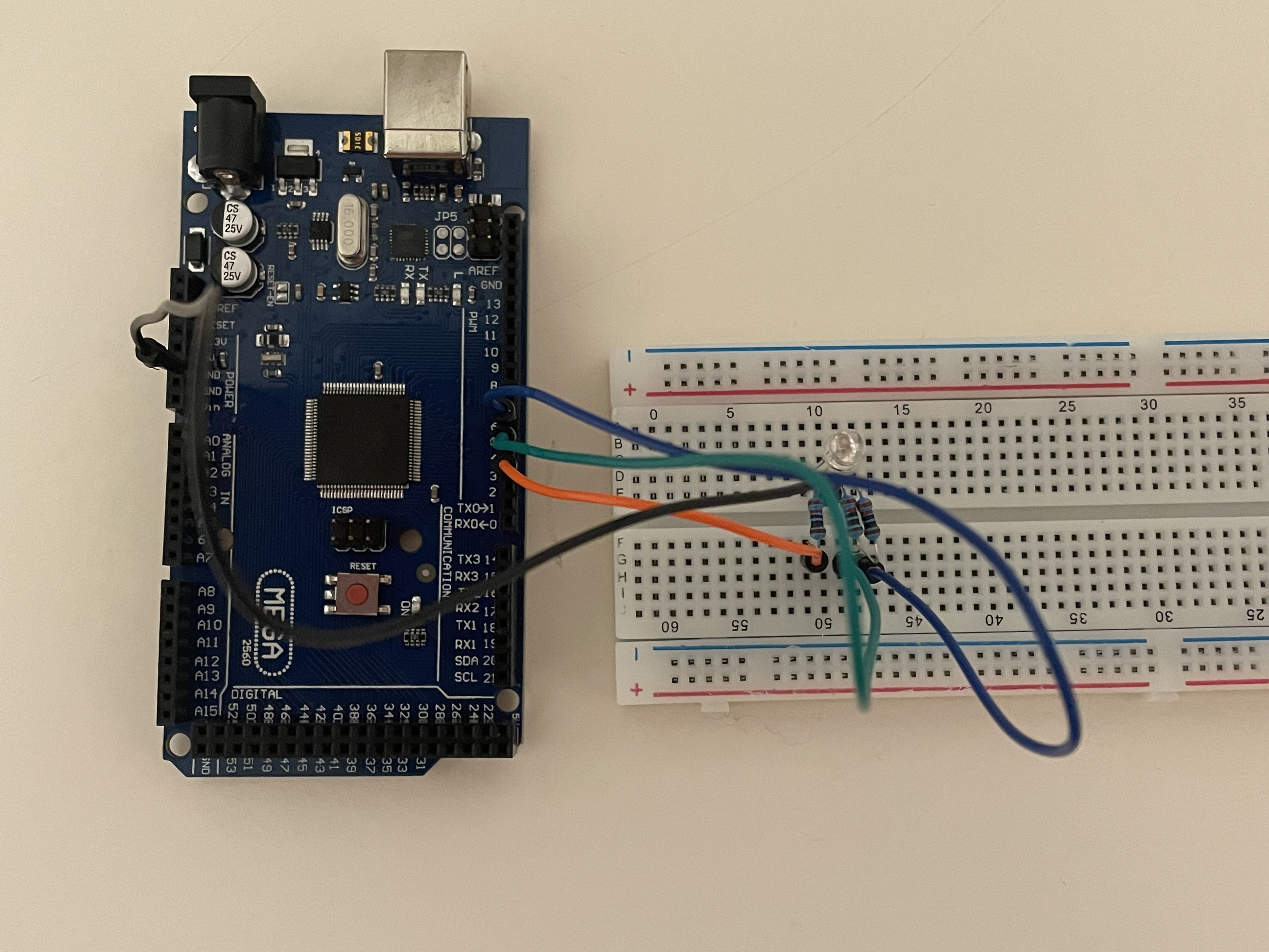

I am new in programming ArduinoCode for a circuit.
What line ending do you have set in the serial monitor?
Do you see the values printed back?
It looks like tutorial about one single function - parseInt()
Are you sure that your RGB LED is common cathode? There are also common anode RGB LEDs. The common anode RGB LED is wired slightly differently, the common lead goes to Vcc. With the common anode, a 0 will turn a LED on and 255 will be off.

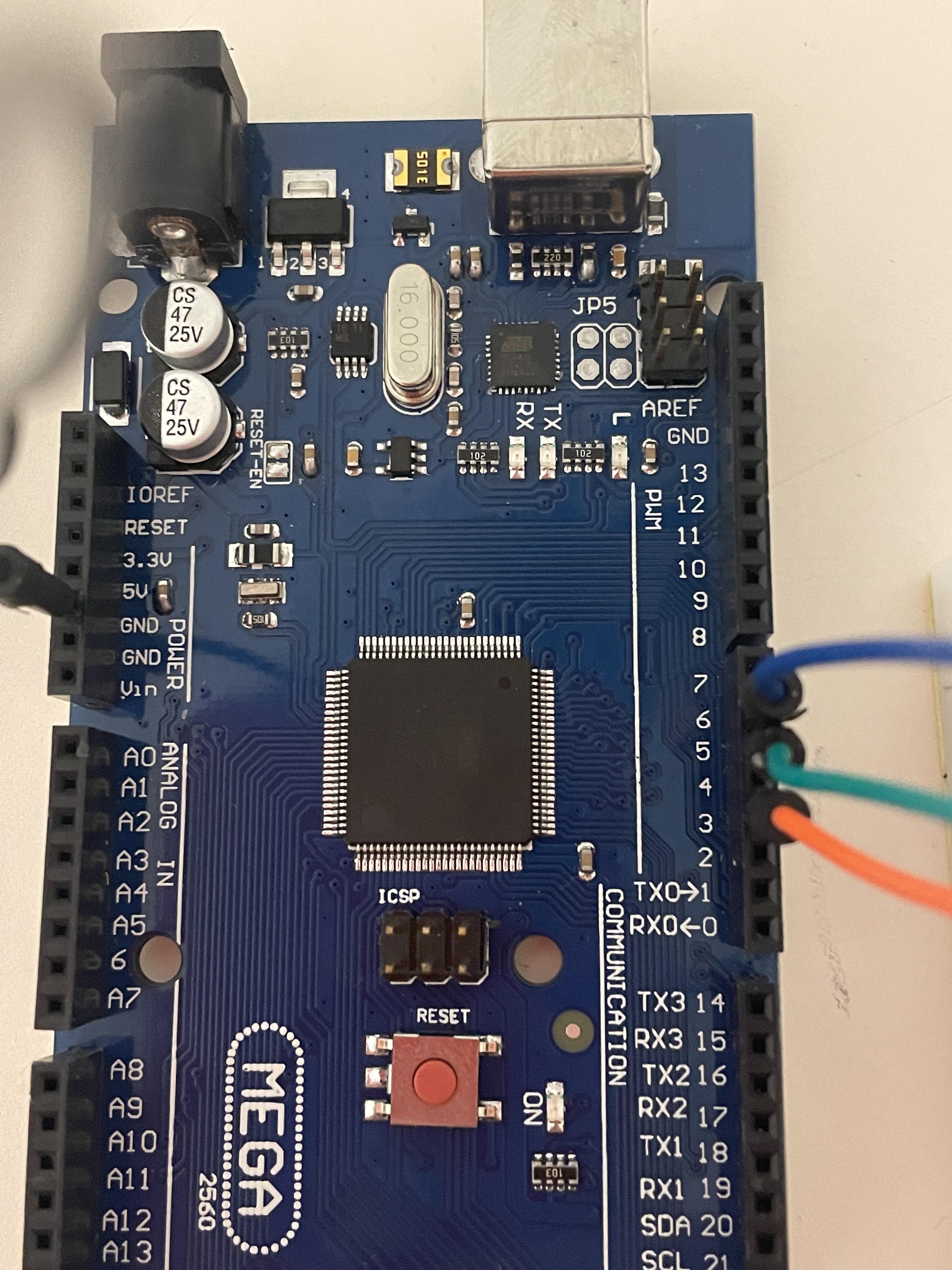

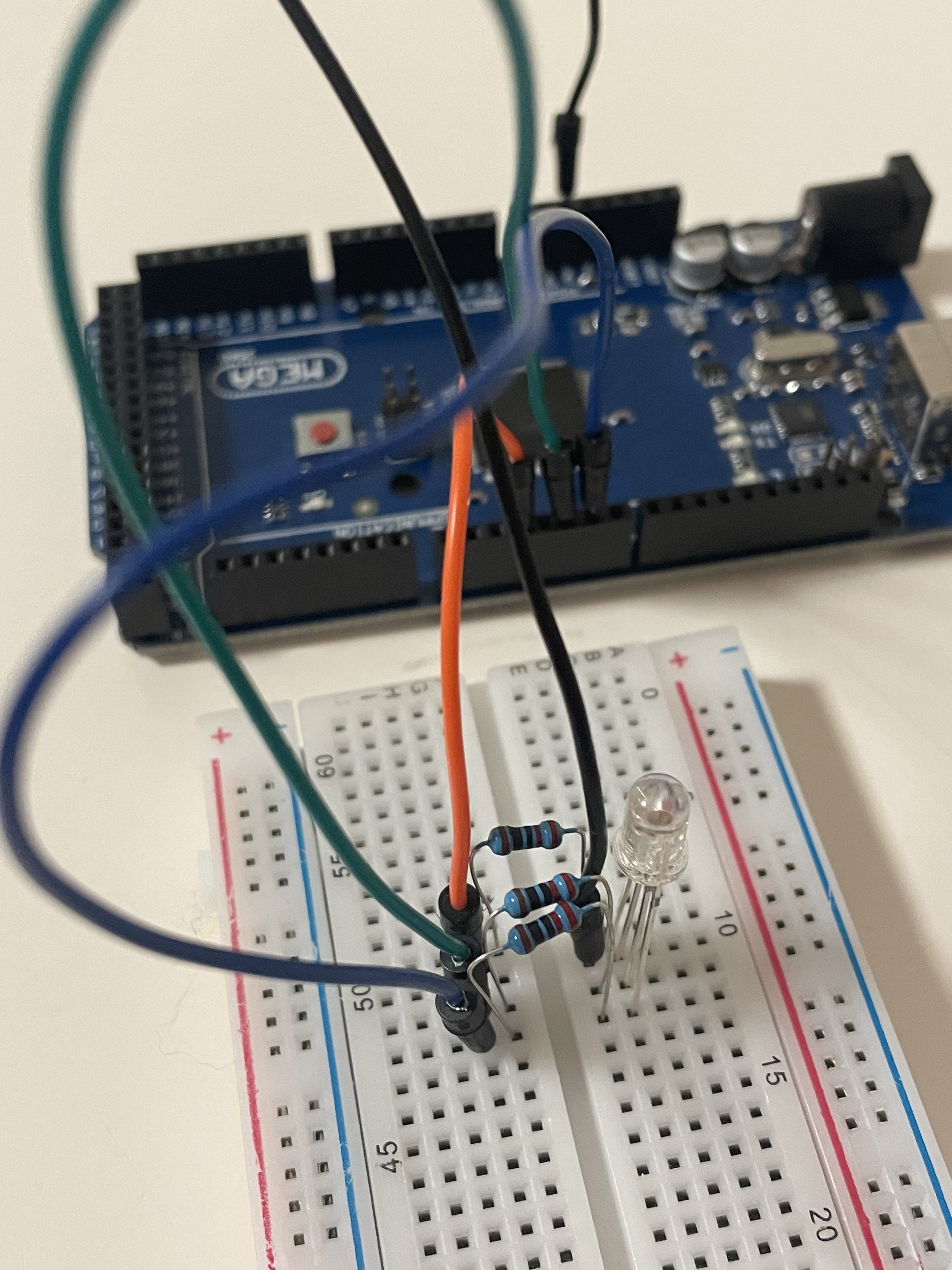

Please post a photo of your actual hardware connections. Did you test the LEDs independently, by loading the blink sketch and changing the pin number to each LED, in turn?
I will come back on this
Thank you. Any answer to my question? Also consider post #4.
I didn’t because it‘s one single RGB LED and not 3 separate LED’s. This has 4 legs.
That means it IS 3 separate LEDs. They just happen to be all enclosed in the same plastic package.
How do you think the colours of an RGB LED are controlled? You are evidently missing the main learning point of the exercise.
You mean this? Nothing seems to be wrong here.
