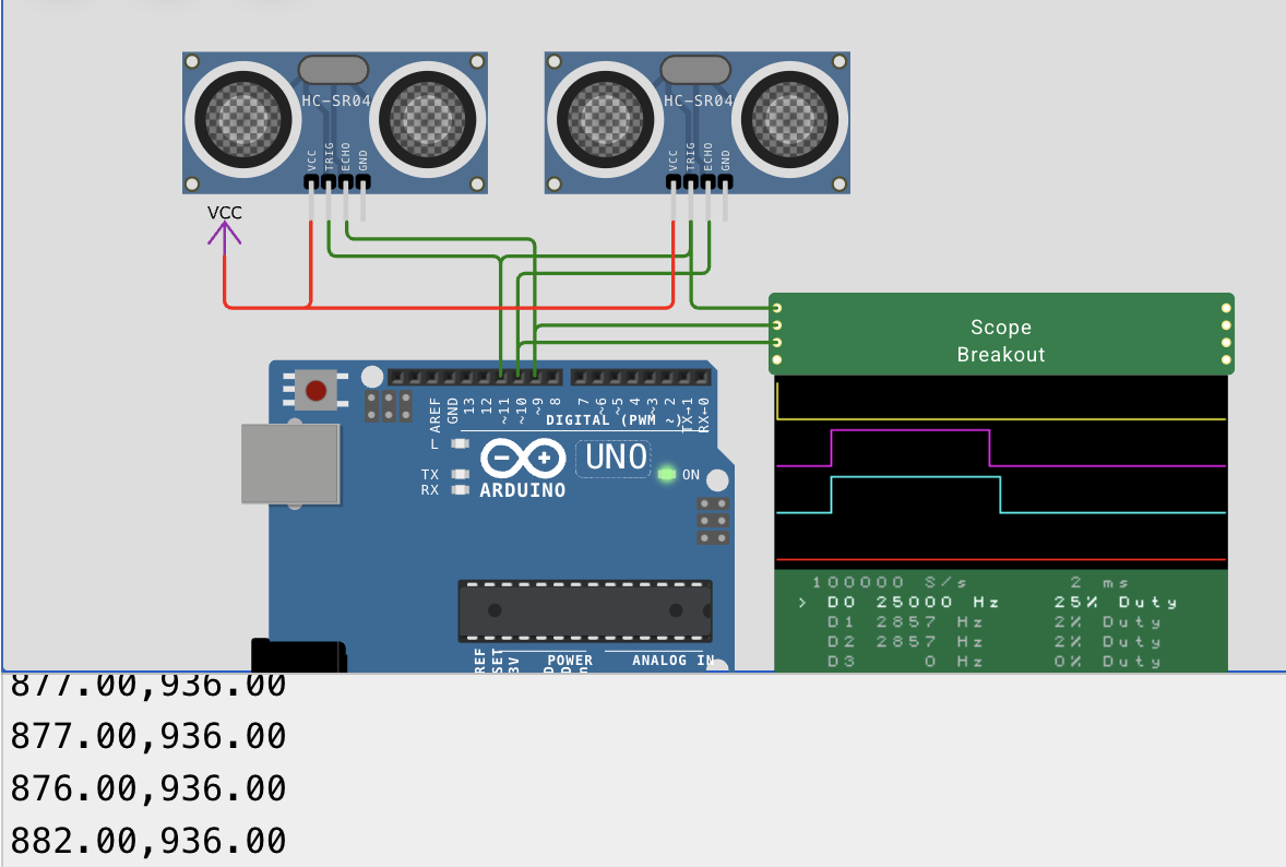

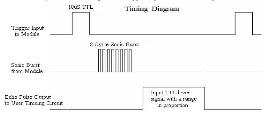

It does, but the echo-detection circuitry inside an HC-SR04 sensor is processed into one long, clean, single pulse per trigger:
Since, in the #1 code, both trigger pulses are essentialy simultaneous, then both leading edges of the echo pulses will be simultaneous.
This is a Wokwi sim for a different purpose, but it shows a clean overlap of the echo signals:
A simulation may not reflect reality.

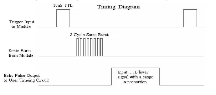

Sure, but the datasheet should represent the behavior of the device.
If you like, cut and paste two datasheet sets of traces, then the first pulseIn should measure length of the HIGH pulse on the first device's "Echo Pulse Output" trace, and the second pulseIn gets to start after the falling edge of end of the first trace, and might well start at while the 2nd "Echo Pulse Output" signal line is still high, and wait for it to return HIGH, or start after the end and wait for apulse that never comes
Draw two sequential pulseIn() durations on these six traces (pins 14 & 32):
