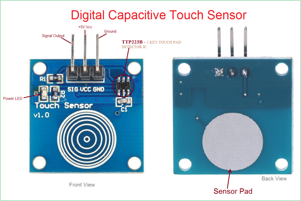

For my project, i buy touch sensor (TTP223b). But this module cant always read input (which is when i touch the sensor) in long period.
So i need this capacitive sensor always read the input because i wanna use it for my brake system. (when i touch the handle in motor cycle then the brake not actived and when i realese the handle then the brake will actived)
I wish when i touch the sensor it will always give HIGH not like the pics in attachment :smiley:
(Always High when i touch the sensor for long time till i untouch it)
btw i keep thinking what i should do, if i wanna make touch sensor wider to cover the handle in motorcycle :smiley: (like i use foil to cover handle then connect it with the sensor but idk how :o )
Pls help me :D, and thank you :slight_smile:
I attach the touch sensor module and the screenshoot from my arduino serial monitor, hope it will help :smiley:
TTP223 modules won't stay triggered for long, and how can i make this sensor always triggered for long, thats the point of my problem :smiley:
{How can i make Touch Sensor which is always trigger when i touch it and give HIGH, and when i dont touch it it will not triggered or give "LOW".
I already buy "TTP223B" as touch sensor module for arduino but that sensor cant always trigger when i touch (it will give HIGH when i touch it till 5-6 seconds and it will give LOW until next triggered)
Maybe thats because Auto Callibrating Mode from the IC in that module.
So can i remove auto calibrating in ttp223B or make it more longer like 1 hours maybe :smiley:
OR Can i buy another touch sensor which is always trigger in long times, maybe 30 minutes ?
OR How can i build touch sensor which always trigger when i touch it (atleast 30 minutes) :smiley:
Thank you for ur HELP, this project really important for me :DD, PLS Help Me :confused: :confused: }

No, i only want the sensor go HIGH when i touch the sensor, but the problem is the sensor keep recalibrating or maybe other reasons. So when i touch the sensor, it will give HIGH for 5-6 seconds and go to LOW even when i still touch it (it will HIGH again if i retouch or move my finger then every 5-6s they will do the same) :confused:
I see.
I have them, but never noticed that kind of behaviour - don't have those sensors at hand now (my toolkit is on the other end of the continent), but in a few days I will be playing with them and maybe can try this out. Not sure as they're built into a project already :slight_smile:
