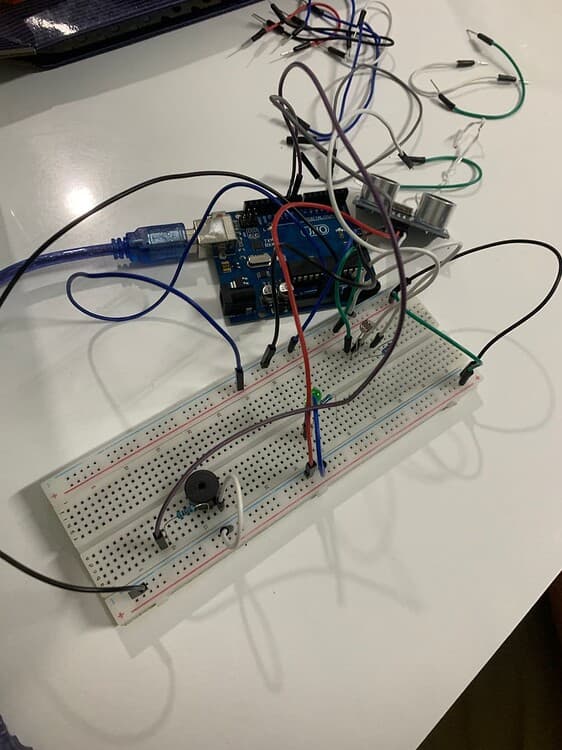

Hi, we're making a vending machine. Using Arduino, we want it to do this: when motion and light are detected, a servomotor is activated, which moves the lever and sounds a buzzer to indicate that the container has been reset (filled), and at the same time, an LED is turned on.
(We have the code, but we don't know how to connect it efficiently and make it work;-:wink:
We're desperate for help or advice. We should do it for you. Thank you for your attention. :pensive_face: sob:

So say many... Your code "compiles" but what do you observe not working as you intended?

There are a bunch of delays() that aren’t helping you. You should probably look into the example sketch “BlinkWithoutDelay” and adapt your code to it.
You also don’t want to use pulseIn() as it also blocks the code from doing anything else until it’s done. You should look for an alternative here in the forum as many others have had similar issues.
Can we see the actual vending machine enclosure that you are mounting all this stuff into?

What do you observe your project doing?
Multiple topics, same subject.
And leaving all the mechanical stuff till later?
