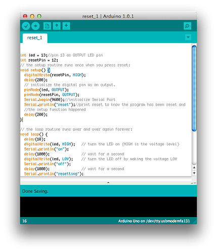

Here they talk about resetting the Arduino with software.
I wonder if a similar thing is happening and keeping it in a reset loop?
