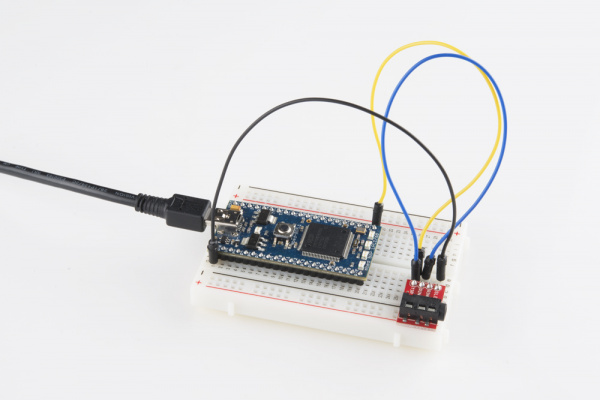

I have seen that mp3 player shield, however I am not interested in paying $30 plus shipping xd. Can I get similar functionality to the mp3 player shield using the circuit in this picture that I have just found and adding a sd card reader? (like this one: https://www.amazon.com/HiLetgo-Adater-Interface-Conversion-Arduino/dp/B07BJ2P6X6/ref=sr_1_3?crid=YS2IJMV8LF8E&keywords=arduino+sd+card+reader&qid=1690949575&sprefix=arduino+sd+card+%2Caps%2C158&sr=8-3 )
9_mbedtutorial-00
source: mbed Starter Kit Experiment Guide - SparkFun Learn
sorry I get confused pretty easily when talking about this stuff I know very little about arduino and electronics in general
