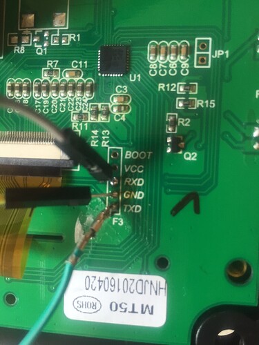

I'm trying to read the data from a solar charge controller using an Arduino. The charge controller has a modbus interface, but for some reason it stops communicating with my Python script running on a Raspberry Pi periodically, making it useless.
I opened up its remote monitor box and found some UART pins, so I thought a good workaround would be to read the data directly from those pins if possible.

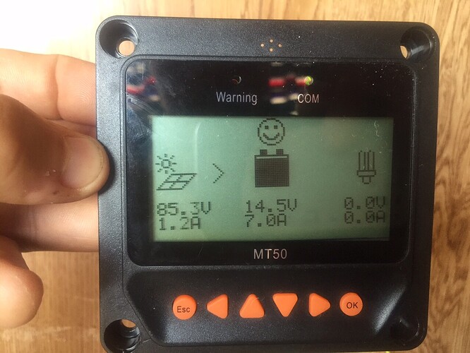

Attached is a picture of the remote monitoring box happily communicating with my charge controller, and of the UART pins I'm connecting to.
When I connect the TX pin from the remote monitoring box to the RX pin (pin 0) on my Arduino (and ground to ground) and run the following script, I get pulses of gibberish characters, which I believe is progress:

But so far I haven't found a buad rate that turns that gibberish into anything that I can make sense of.
Does anyone have any tips?
And I'm new to UART, does it sound like I'm barking up the right tree? When I connect the RX pin of the box to the Arduino's TX pin, the box says "connecting", meaning (I think) that its trying to communicate exclusively over the UART pins. So I'm not completely sure that it's sending its data over the UART pins when there's no connection.

Do you know if the Tx and Rx on the device work at TTL (5v) signal levels?

Your device may or may not use inverted TTL logic on the serial port, like the Arduino does. If you can, check the data with an oscilloscope.

The odd thing is that the MT50 box always communicates just fine. And sometimes connecting that box for a moment will make it so my Python script works again, so I'm wondering if I'm missing something.

Sorry. I was not clear. I wanted to know what is the hardware connection - is it a serial connection or USB or something else?
From looking at the User Manual it seems to be RS485. You can get an RS485 - TTL serial converter and that may be the simplest way to connect the Arduino to it.

I can't see why it would behave any differently just because you connect upstream of the RS485 connector - IF that is what you are doing.
Do you know if the Tx pin you are connecting to is RS485 or not?
Do you know whether the RPi is causing the problem?
