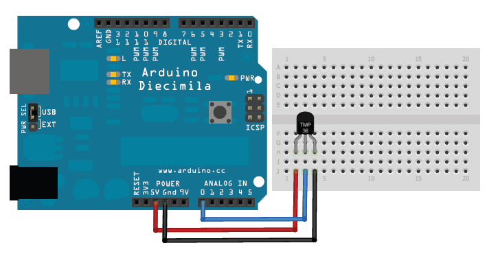

I am fairly new to arduino and I am trying to display a number from a temperature sensor on my 7 segment display, but having difficulty with seperating the numbers.
My thought is that you can split, for example, 24,48 into A=2, B=4, C= 4, D = 8 and then take the value on A to the first digit on the display, B on second and so on.
Is this possible or is there any better solution for this??

Looks ok.
No, no, no. That will damage your Arduino by exceeding the current limits. Or the display. Or both.
You need series resistors, 7 or 8 of them. And if you need your display to be reasonably bright, a transistor for each digit.
Alternatively, a Max7219.
Yes you definitely need some series resistors. Just type in "LED calculator" in Google and you will find some. Get your datasheet handy. Once you have it, here is one such calculator you can use:
http://centipedestudio.com/calculator_led.php
If you have no idea where the datasheet is, could you provide the color? Or the part number on the display? If nothing, then start with a 1k resistor (or a little lower) just to get something visible, get your logic working with some code someone else posted, and work on the brightness later.
